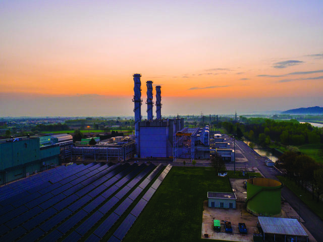

The company turned to GE, which had been a supplier for Chivasso from its earliest days in the 1950s through the new plant in the 2000s (Figure 1). GE’s European Power Services division began with a detailed analysis of the market conditions and what could be done to improve Chivasso and make it competitive again. Mario Cincotta, one of the GE managers on the project, laid out the challenge: “If you are losing money, you don’t want to invest more if you have no clue whether you are ever going to get it back.”
Chivasso Combined Cycle Power Plant
1. Veterans. The Chivasso plant’s original GE steam turbines have been retired in place but remain, along with the original control room, as a stop on plant tours. Courtesy: A2A/GE
The team first looked at upgrading the existing 9FA turbines with GE’s OpFlex Dry Low NOx 2.6+ combustion hardware and control system and new boilers from its legacy Alstom division, a package GE had designed to help older plants like Chivasso. Then came the bad news: Analysis of market data showed that even with all the hardware upgrades, the plant would still fall short. The newer plants nearby would still beat it in the market. More would be needed if Chivasso were ever going to start up again.
That’s when Cincotta and his team looked at upgrading the control system and software with GE’s Operations Optimization system in addition to the upgraded hardware. The Operations Optimization software, built on GE’s cloud-based Predix platform, gathers sensor data from across the plant and, using advanced analytics, helps operators manage the OpFlex system controls to quickly react to market conditions, lower operating costs, and reduce the plant’s emissions. Using this approach, the staff at Chivasso would not just be able to operate the plant more efficiently, but the plant would also be more competitive in the market. (For more on Predix and how cloud-based computing can change plant operations, see “Big Data and the Industrial Internet Meet the Power Plant” in the January 2016 issue or online at powermag.com.)
Analysis of this package of upgrades showed that the Chivasso plant would be able to compete and earn enough revenue in the ancillary services market to justify renewed operations. It would be able to ramp 2.5 times faster than before—50 MW per minute—and operate at 65 MW minimum load, ranking it among the best performers in GE’s 9FA fleet. A2A opted to upgrade two of the existing turbines according to the GE plan (the third remains mothballed for now).
Back in Action
The upgrade work was completed in November 2015, and A2A returned the plant to service. Since then, Chivasso has logged thousands of hours of operation, vindicating the decision to bring the plant out of mothballs and commit to the upgrades. In addition to its return to profitability, Chivasso’s emissions of NOx and CO were cut by half. A video of the project can be viewed below.
