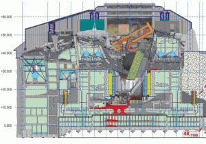

Now, 30 years later, we know quite a bit more about Chernobyl. No immediate civilian fatalities occurred, but as many as four dozen (the number is subject to contention) brave first responders — plant workers and firefighters — died gruesome, early deaths from radiation poisoning. Authorities evacuated a large population (some 115,000 people). The terrain remains largely unpopulated today, although wildlife appears to be thriving. The costs continue in terms of the ongoing efforts to entomb the radioactive hulk in a concrete coffin, the second approach to burying the radioactive wreckage. The first sarcophagus, a slapdash lump of concrete and steel, failed.

We also know the root cause of the plant’s explosion, an unintentional dirty bomb that spread radiation over much of Western Europe. The graphite-moderated, water-cooled reactor (designed to make both civilian electric power and weapons-grade plutonium) had an inherent flaw: a positive void coefficient of reactivity. If the plant lost coolant, the still-moderated nuclear reaction increased exponentially. That’s unlike Western and other Russian light water reactors, where the coolant and the moderator are the same. A loss of coolant in a light-water reactor shuts down the nuclear chain reaction as the moderator also vanishes and the chain reaction halts. Of course, dealing with the heat left behind is a major safety issue, as was the case at Three Mile Island.
When Chernobyl plant technicians performed an ill-advised, low-power experiment that April, they lost control of the machine. The plant lost coolant and went into a wild power excursion. The graphite moderator continued allowing the core to fire slow neutrons. The reactor went prompt critical; the heat and water produced a steam explosion; the top of the reactor vessel blew off. The graphite caught fire and spewed high into the atmosphere. Talk about a carbon footprint.
