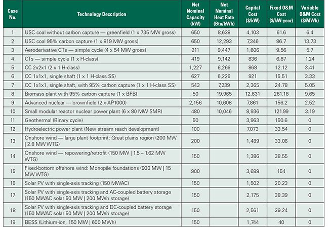

Cost pressures amid inflation and market demand further compound these challenges. Power sector O&M costs typically fall into fixed costs and variable costs. Fixed costs cover consistent expenses like routine maintenance, staff salaries, and long-term equipment contracts, while variable costs fluctuate based on fuel prices, material needs, and unexpected repairs. Over the past five years, cost fluctuations have hinged emphatically on rising material costs for critical resources such as steel, copper, and silicon, with particular implications for aging thermal power plants that require frequent and costly repairs.
Table 1. A December 2023 U.S. Energy Information Administration (EIA) cost and performance survey conducted by Sargent & Lundy summarizes costs for most technologies, including overnight capital cost information, fixed operating and maintenance (O&M) costs, and variable non-fuel O&M costs. Notes: USC = ultrasupercritical; CTs = combustion turbines; CC = combined cycle; SS = single shaft; BFB = bubbling fluidized bed; MWAC = megawatt alternating current; WTG = wind turbine generator; BESS = battery energy storage system. Source: EIA, Capital Cost and Performance Characteristic Estimates for Utility Scale Electric Power Generating Technologies, January 2024.
Renewable O&M costs, while generally lower than those of thermal power plants, have been steadily decreasing due to technological advances, economies of scale, and experience-driven efficiencies. However, they remain sensitive to material price volatility and the growing demand for specialized maintenance services. Offshore wind, in particular, faces higher O&M costs compared to onshore wind, driven by logistical challenges, harsher environmental conditions, and the need for specialized vessels and remote monitoring systems. Meanwhile, costs for advanced technologies such as biomass and small modular reactors remain comparatively high. A cost and performance analysis conducted by engineering firm Sargent & Lundy compared 19 different technologies based on their capital and O&M costs (Table 1). Even as these emerging technologies promise operational efficiencies and decarbonization benefits over time, their high upfront investments and significant ongoing O&M expenses can pose serious feasibility challenges.
