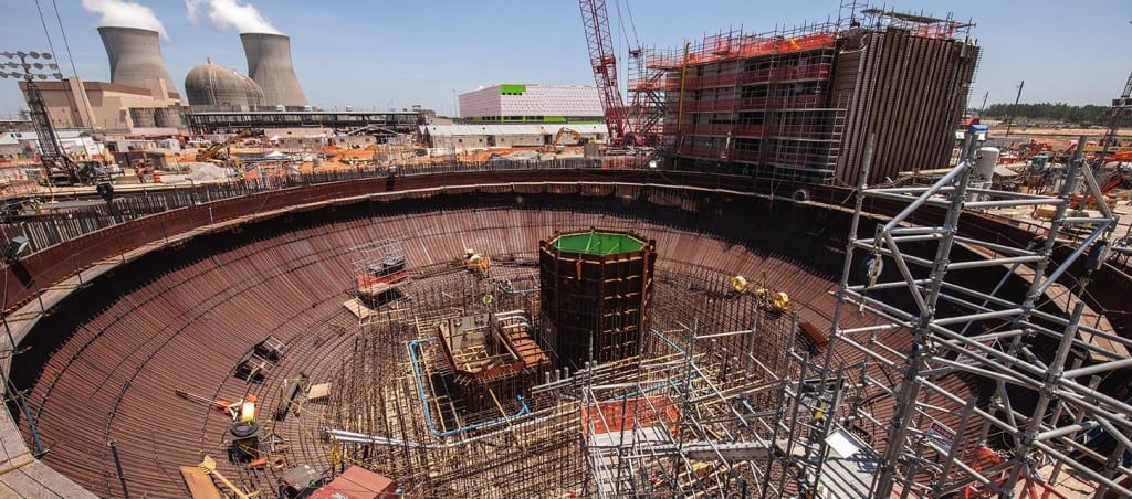

On December 4, Georgia Power announced more remarkable milestones for the project, noting placement of the fourth of five sections that will make up the containment vessel at Unit 3 has been completed.
Workers placed the third—and final—ring as well as the fourth and final reactor coolant pump (RCP) for Unit 3, the company said. Placement of the ring means that a final piece—the containment vessel top head—remains, and it is expected to be placed in 2019.
The ring weighs just under 2 million pounds, and it is approximately 38 feet high and with a diameter of 130 feet. The 375,000-pound RCP was mounted to the steam generator and will serve as a critical part of the reactor coolant system. “The pumps, coupled with each steam generator in the AP1000 reactor design, can be operated at variable speeds during the reactor’s heat-up and cool-down processes. During regular operations, each RCP runs at 1,800 revolutions per minute,” Georgia Power noted in a statement.
In November, the company completed placement of the first two sets of double-decker shield building panels along the outer wall of the Unit 3 containment vessel. The feat required a team of about 15 individuals, ranging from a crane operator, riggers, spotters, engineers and project managers who work together to ensure each section is placed precisely. “The shield building panels are a unique feature of the AP1000 reactor design at the Vogtle nuclear expansion, providing an additional layer of safety around the containment vessel and protecting it from any potential impacts. To date, more than half of the shield building panels have been placed for Unit 3,” the company said.
Work is churning along at Unit 4, too. In October, workers placed two key floor modules—CA35 and CA33—which were to be followed by large concrete placements inside the Unit 4 containment vessel. “CA35 is the roof above the accumulator and CA33 is the roof above the chemical volume control system,” the company said. “Weighing nearly 72 tons, the two modules bring the elevation inside containment to 107 feet—the elevation of the maintenance deck. Since placement, additional work will begin installing rebar on the north side of containment, which will be followed by a concrete placement. These milestones support the upcoming installation of structural steel pieces that support the subsequent floor elevation.”
