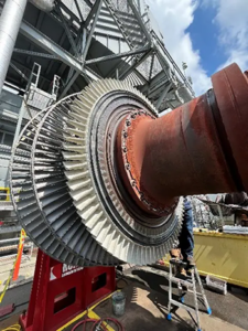

For these outages, the turbines’ first, second, and third stage buckets were removed and replaced with Customer provided components.
MD&A New turbine blades on 7FA.04 rotor

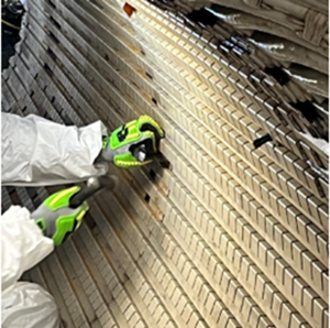

MD&A experts inspected the generator stator and found areas of greasing indicated a loose wedge structure and necessitating a full stator rewedge. Core and bellyband tightening was also required.
MDA_Wedge-tapinspection-in-proces
Wedge tap inspection in process
Stator electrical testing was completed, and electromagnetic core imperfection detections (ELCID) tests were conducted before and after wedge replacement.
