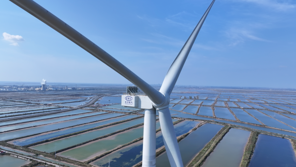

Chinese manufacturer Dongfang Electric Corp. commissioned the world’s largest operational wind turbine in late 2025: a 26-MW behemoth (Figure 3) featuring 150-meter (m, 492-ft) blades and a rotor diameter of 310 m (1,017 ft). Goldwind launched its 22-MW platform in December 2024, while most other major Chinese original equipment manufacturers now offer turbines rated at 16 MW or greater, GWEC reported.
Donfang-26-MW-offshore- wind-turbine
3. The 26-MW offshore wind turbine developed by Dongfang Electric Corp. is currently the world’s largest unit. The first grid connection of this design was successfully completed on Oct. 29, 2025. Source: State-owned Assets Supervision and Administration Commission of the State Council

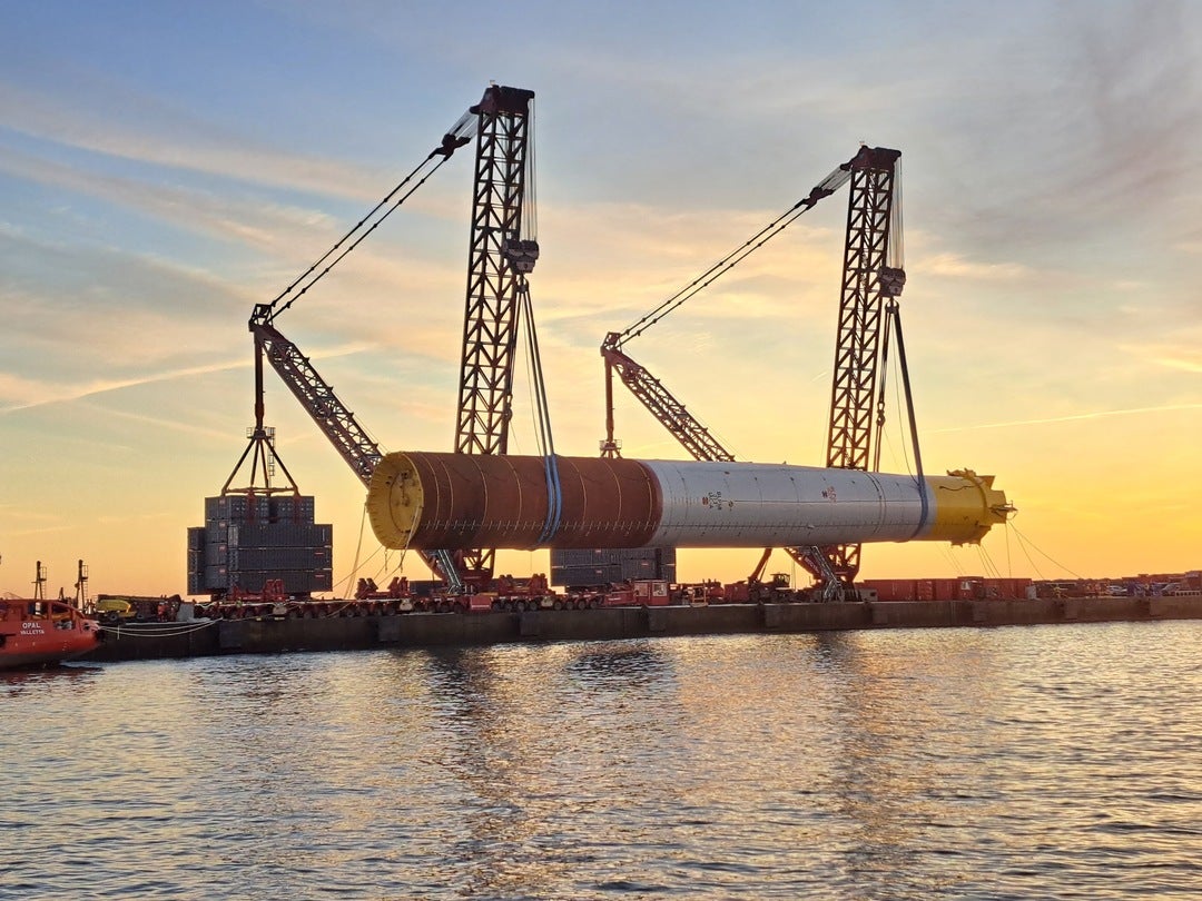

A notable innovation in monopile logistics debuted at the Windanker project in Germany during 2024–2025. Dutch heavy-lift specialist Mammoet deployed its XXL monopile transport system at the port of Rønne in Denmark to marshal foundations for the 315 MW project. The system employs MTC1600 terminal cranes (Figure 5) with a combined lifting capacity of 3,200 tonnes, capable of handling monopiles up to 2,150 tonnes and 87 meters in length.
Mammoet-monopile-cranes-offshore-wind
5. With the ballast weight of the MTC crane positioned much further away from the pivot point of the boom, in comparison to a large crawler crane, the load-bearing pressure was far less. This helped to spread the load over a greater distance, avoiding the need for specialist foundations or temporary civil work. Courtesy: Mammoet
The significance lies in operational efficiency. Conventional monopile handling requires extensive port reinforcement, Ro-Ro (roll-on/roll-off) operations, and sequential vessel loading. Mammoet’s approach eliminates ground reinforcement requirements and enables continuous feeding of installation vessels—a critical capability as project scales increase and weather windows constrain offshore operations.

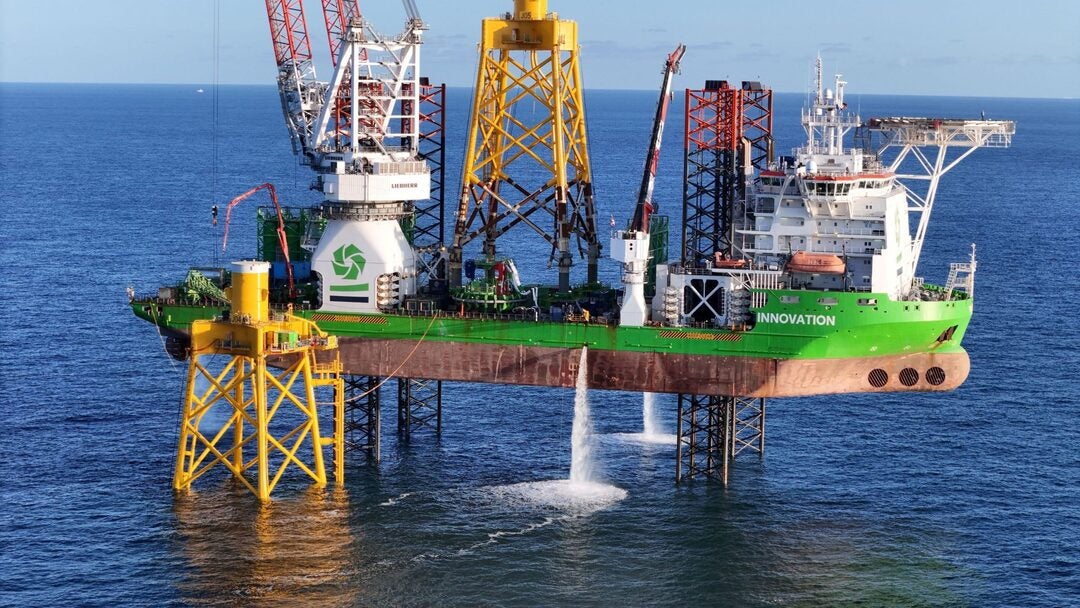

Dieppe-Le Tréport in France is a 496-MW project (Figure 6). Ocean Winds’ consortium installed the project’s first jacket foundation in September 2025. The 62-turbine array, located 17 km offshore, secured €2.4 billion ($2.8 billion) in financing in April 2023, with Sumitomo Mitsui taking a 29.5% stake. Commercial operation is expected in 2026.
Ocean-Winds-First-Foundation-at-the-Dieppe-Le-Treport
6. The successful installation of the first foundation at the Dieppe-Le Tréport offshore wind farm was announced on Sept. 10, 2025. For such operations, specialized vessels raise themselves above the waterline on extendable legs, creating a stable platform for precision heavy-lift operations in open seas—a capability essential to the global expansion of offshore wind. Courtesy: Ocean Winds
