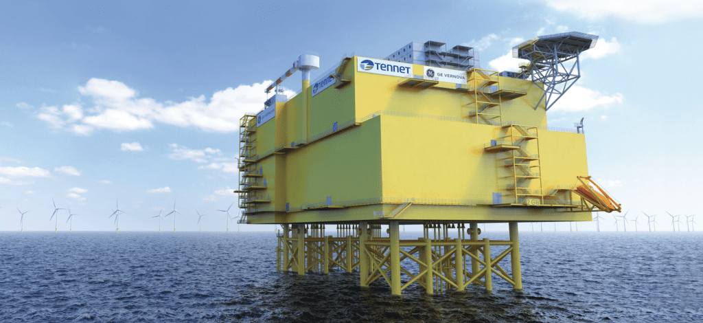

TenneT’s 2 GW Program. TenneT, the transmission system operator (TSO) for the Dutch-German region, finalized a major agreement for its 2-GW program, which entails deploying 14 HVDC transmission systems, each with a capacity of 2 GW. This initiative is set to be executed in the Dutch and German sectors of the North Sea, with completion targeted for 2031. The primary objective of this ambitious project is to bolster offshore wind energy supply and enhance the renewable energy framework across the region.
The deployment will introduce a substantial offshore wind energy capacity of 28 GW, aligning with about 30% of the European Union’s (EU’s) renewable energy expansion targets. TenneT is focused on optimizing transmission capacities to achieve up to a 50% reduction in the environmental impacts related to offshore wind energy transmission. This project is expected to facilitate the delivery of clean wind energy from the North Sea to approximately 35 million households, supporting regional sustainability objectives. This initiative underscores TenneT’s commitment to advancing offshore wind infrastructure, facilitating large-scale renewable energy integration, and driving sustainable energy solutions for the future.
