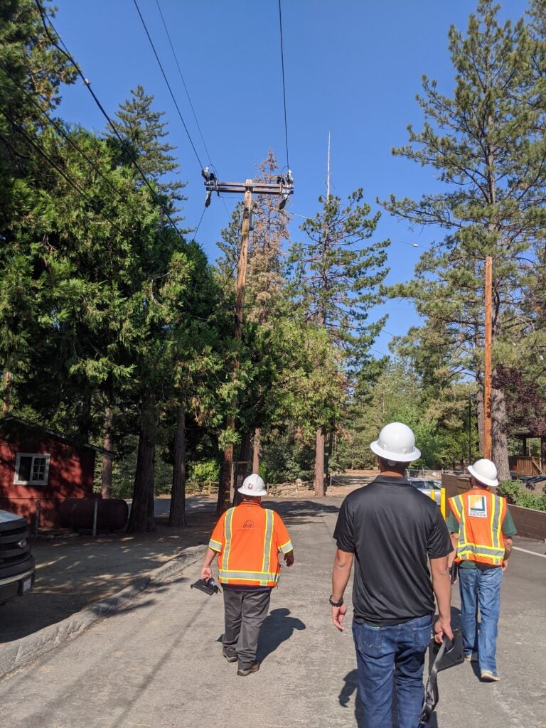

Wildfire mitigation has always been important to utilities, particularly in the West, but it took on a much higher level of importance after the Dixie Fire in 2021. That fire was sparked by an untrimmed tree limb coming in contact with a live power line during high-risk conditions in northern California. The American West had already suffered through years of wildfires that were increasing in frequency and intensity, including the summer of wildfires in 2020 that blanketed so much of California, Oregon, Washington in thick smoke. Then came the Dixie Fire the following summer, which burned nearly a million acres, destroyed multiple towns, and prompted record-breaking lawsuits.
1. Power lines that are close to vegetation need to be maintained to help mitigate the potential for wildfires from faulty equipment, or damage to the lines that could spark a fire during extreme weather events. Source: Locana

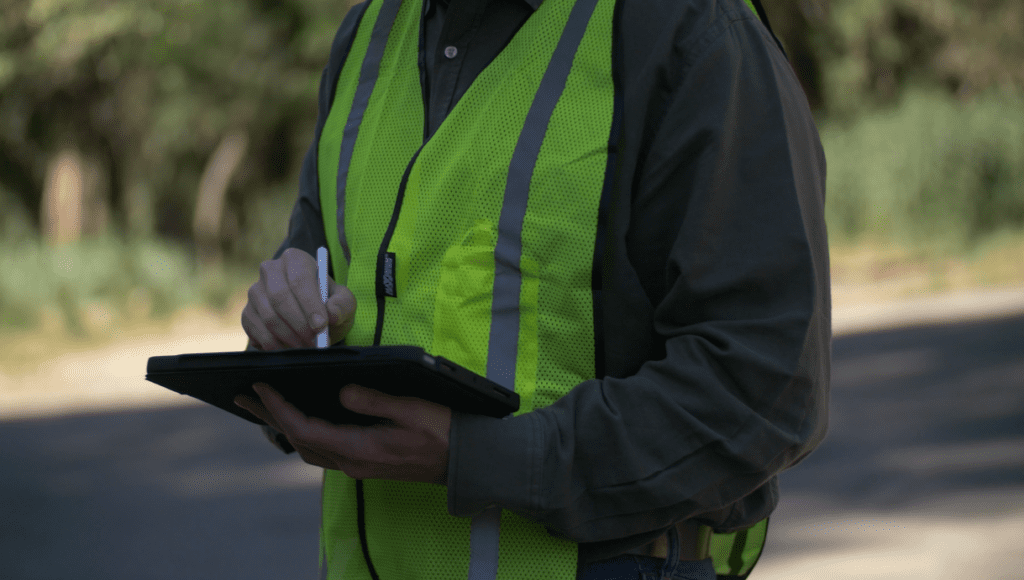

Luckily, precision is at the heart of new best practices for wildfire mitigation being implemented by a number of the utilities working with Locana and other groups on mitigation efforts. It is being driven by the use of advanced geospatial systems in combination with technologies like mobile tablets (Figure 2), computer vision and generative artificial intelligence (AI). This combination of technologies is giving field crews, department heads, GIS departments and senior decision-makers the ability to be far more precise with their mitigation efforts—driven by data and insights that are richer, more easily accessible, and easier to translate into decisions and actions.
2. Work crews can use mobile tablets and other devices to access data that supports field maintenance of power infrastructure. Source: Locana

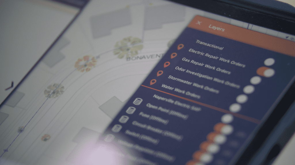

Geospatial technology today has the ability to play a key role in wildfire mitigation because it delivers critical intelligence and actionable insights from the massive volume of data (Figure 3) that utilities have access to from their infrastructure, mobile tablets, sensors, GIS systems, operational databases, satellites, and more. It has the power to drive faster, more informed, more effective decision making. And that is critical to performing wildfire mitigation in a way that is both successful and more precise.
3. Utilities have a wealth of data available to support maintenance of assets across their territory. Source: Locana

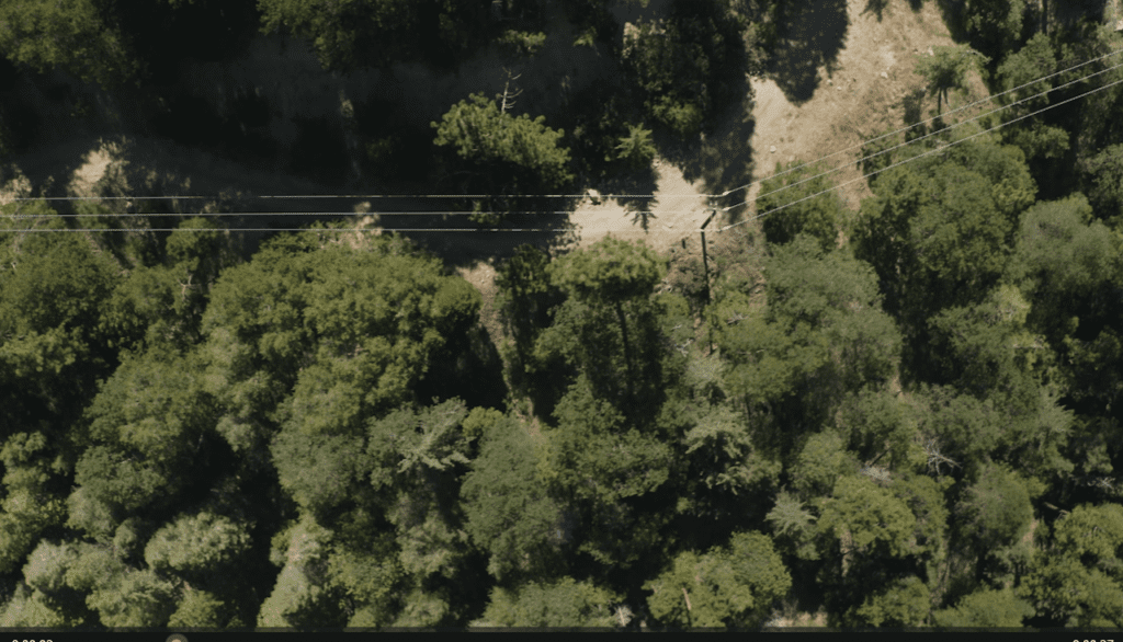

Plant identification is a perennial challenge for field crews. Many trees and plants look quite similar to one another (Figure 4) yet have far different growth patterns and pose far different dangers to infrastructure.
4. Field crews need to be able to identify vegetation that could pose a risk to power transmission infrastructure. Source: Locana
That is particularly true when plants and trees are early in their lifecycle before they make large jumps forward in size. One plant that is 10 yards away from the edge of a buffer area around a high-power transmission line might be low risk as it grows, while another that looks very similar poses a high risk when it is the same distance away. To reduce the chances of mis-identification, mobile tablets can be equipped with computer vision that enables accurate plant identification so workers can decide where to focus their trimming.
