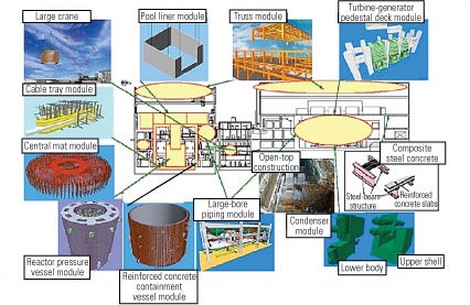

  • Detailed preconstruction engineering to avoid site rework (Figure 2).
  • More extensive use of open-top installation techniques.
  • Employing prefabricated modules and floor packaging construction methods (Figure 3) to reduce manpower and distribute it more evenly throughout the project.
  • The use of sophisticated, 3D computer-aided design (CAD) at all engineering stages, with the construction support system interfaced with the CAD system.
  • Electronic data exchange among owners, contractor, and subcontractors.
  • Application of radio frequency identification (RFID) technology to improve documentation and record-keeping.
2. Prefabrication saves time. Large modules are shop-fabricated and then assembled on site, using techniques that resemble manufacturing more than site construction. Courtesy: Hitachi
3. Stacking modules. 3D computer-aided design and manufacturing techniques are integral to the advanced fabrication and assembly process. Courtesy: Hitachi

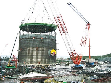

5. Prefabricated concrete vessels. The reinforced concrete containment vessel (RCCV) is a unique feature of the ABWR. Located inside the reactor building, it enables construction and installation work to proceed concurrently. Installation of the RCCV is a significant milestone on the construction schedule’s critical path. This photo shows erection of the RCCV liner module, including the liner plates, the innermost vertical and horizontal rebar, and the shell wall. Not shown, but part of the technique, is the base mat module. It includes the pedestal of the reactor pressure module, quencher anchor bolts, and a three-layer radial rebar configuration. Courtesy: Hitachi

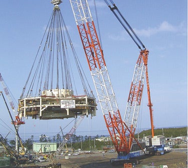

6. Heavy lifting. The RCCV upper drywell weighs 650 tons. It houses many of the drywell’s internal components, such as the shielding wall, pipe whip restraint structures, cable trays, and the piping and valves of the primary system. The lower drywell area of the RCCV contains such sensitive equipment as the reactor’s internal pumps and fine-motion control rod drives. Modularizing such components requires highly detailed preconstruction engineering before installation. Courtesy: Hitachi

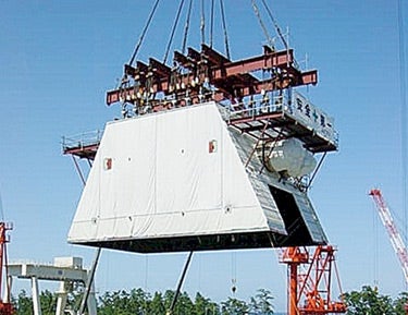

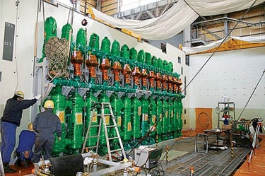

8. Some assembly required—at the factory. This photo shows the hydraulic control unit (HCU) being assembled at the factory (rather than in the field), with the cooperation of the project’s owner/operator and civil contractor. The unit is a complete room containing the building structure (walls and floor), installed equipment, and all accessories. Factory assembly ensures that the unit will remain water-tight during construction after reaching the site. Courtesy: Hitachi

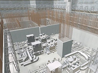

Because Hitachi now exchanges design and construction data electronically with its civil engineering contractors, any adjustments can be made in detail during a project’s preconstruction phase. Among other things, sharing data through a common 3D-CAD platform permits parallel construction. Using computer screens to show where to set scaffolding and install equipment simplifies the collaboration process and makes it more precise. Another benefit is that all contractors can share temporary site facilities to a greater degree.
Hitachi uses the 3D-CAD platform in the field for construction schedule simulation, yard utilization planning, and installation of large equipment and modules. Module scope planning also is executed on the platform. Finally, Hitachi distributes work instructions for essential on-site preassembly and installation using 3D animations. The 3D-CAD platform interfaces with a construction support system interface that all subcontractors use.

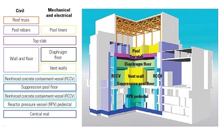

Here are two examples of benefits. To mitigate peaks in on-site labor force, Hitachi has adopted the "floor packaging" construction method (Figure 9). With floor packaging, hydro-testing is conducted at each "floor" (partial hydro-testing), rather than waiting for the entire plant to be completed. Equipment in the basement is hydro-tested while the higher floors are still under construction. Hitachi also has developed a weldless closure jig to make partial-pressure tests more efficient. This approach avoids the need to have a new group of workers on hand during the scheduled full hydro-test period.
9. From the ground up. Floor packaging of modules reduces installation and start-up labor and, more importantly, construction time. Source: Hitachi
