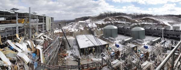

1.    Preventable tragedy. Workers at the Kleen Energy Systems plant in Middletown, Conn.,  attempted to clean debris in the plant’s fuel gas line with 650 psi natural gas. The gas purge, vented inside the plant building, found an ignition source and exploded. Six workers were fatally injured. Courtesy: Chemical Safety Board
To avoid a repeat of this and similar disasters, engineers and designers must be thoroughly trained in the code and practical design requirements for natural gas piping. Contractors should be especially cognizant of the safety requirements and worker training required when purging natural gas piping. In our experience, few engineers and contractors have the necessary knowledge or experience to safely purge and start up natural gas piping systems. It’s time to take a deep breath and reevaluate our commitment to safely handling natural gas in utility plants (Figure 2).

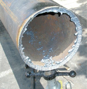

2.    Never completely clean. Weld slag and contamination are rarely completely removed from a piping system. A well-designed pipe purge configured with strainers and sediment traps can be safely accomplished with the right planning and training. Courtesy: CEC Combustion Safety Inc.
