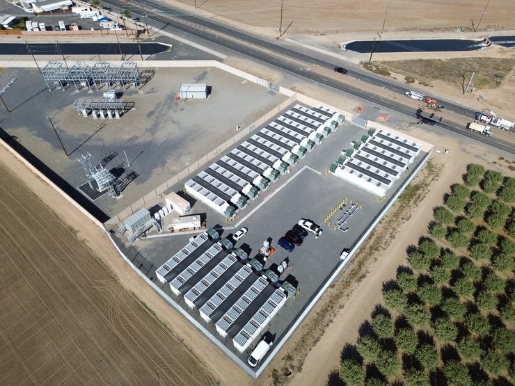

1. Enchanted Rock recently commissioned the company’s largest dual-purpose microgrid in the U.S. to date. This project, serving a water treatment plant, is the first of three community microgrids in California that will deliver a combined 146 MW of fast-response, dispatchable power back to the grid during peak demand and provide reliable power for vulnerable communities historically impacted by frequent outages. Courtesy: Enchanted Rock
Schurr told POWER, “In these periods, the performance of conventional resources must be assured and data analytics will be needed to ensure performance when it’s needed. For example, in extreme heat, derating of transmission lines due to high temperatures and loading could create a need for more local dispatchable capacity. Likewise, extreme cold can be difficult to forecast given growing electric heating, so the forecast error needs to be expanded and appropriate contingency addressed. In both of these instances, data analytics increases asset performance and system operations through real-time sensing, modeling, and decision support.”
