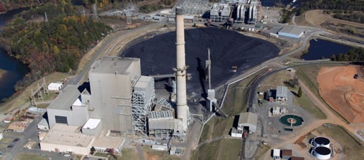

Overview of the Sutton Plant. Courtesy: Duke Energy
Overview of the Sutton area. Courtesy: Duke Energy

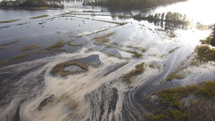

Duke Energy on September 19 said water and approximately 2,000 cubic yards of soil and ash eroded from the Sutton landfill. “Much of the nonhazardous material, which would fill about two-thirds of an Olympic-sized swimming pool, was captured in a perimeter ditch around the landfill, and cleanup work has already begun,” it said. Courtesy: Duke Energy

Floodwater entered the footprint of the 625-MW Sutton natural gas combined-cycle plant on September 21. Courtesy: Duke Energy
Floodwater entered the footprint of the 2013-built 625-MW Sutton natural gas combined-cycle plant on September 21. Courtesy: Duke Energy
Duke Energy warned that the situation was dire. “The rising river continues to overtop the north end of the cooling lake dam, a surface that is protected by a layer of compacted soil and cement,” the company said. “Water is now exiting the cooling lake through breaches—one large and several smaller—on the southern end of the impoundment.” The cooling lake water also “flowed into the natural gas plant footprint,” prompting the company to close it.
