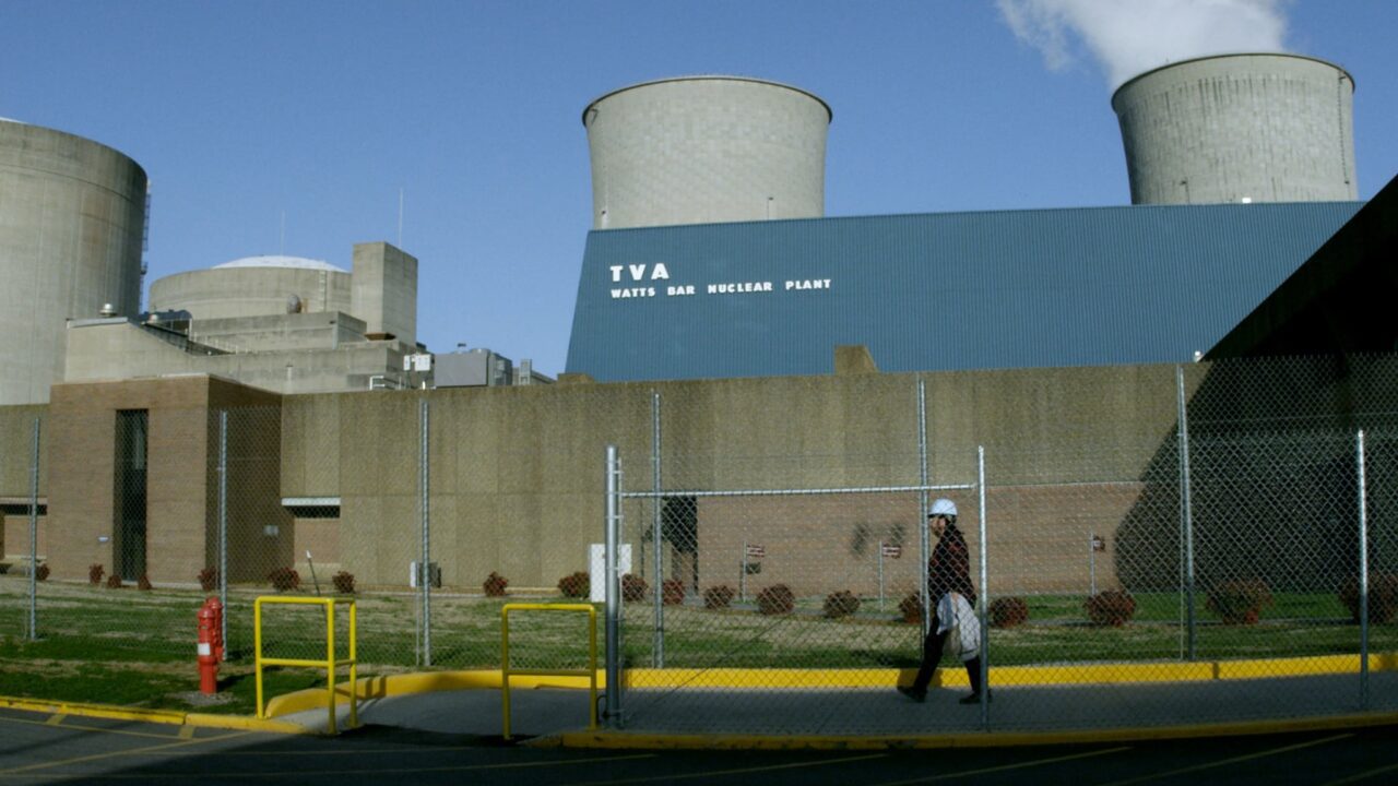

First the good. The Tennessee Valley Authority says it expects to bring its Watts Bar 2 unit in service sometime this year. That will add 1,150 MW to TVA’s generating capacity.
Then the bad. Watts Bar 2 was started 36 years ago in 1979. TVA halted construction on the project in 1988 at about 80% completion, during the time the U.S. Nuclear Regulatory Commission forced the giant public power agency to close all of its operating nuclear units. TVA began construction on Watts Bar 1 in 1973 and the plant didn’t come into service until 1996, after also being stalled by TVA’s long-lasting nuclear shutdown.
