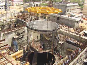

9.    Crowning dome. India’s first large nuclear power plant, at Kudankulam in Tamil Nadu state, will comprise two AtomStroyExport-designed VVER-1000 reactors. Courtesy: AtomStroyExport

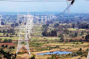

Ghodawat said that the largest constraint on the government’s renewable energy expansion plans is the weak grid (see sidebar "A Passage for India’s Power"). "But now the government and all wind sector players are jointly making corrective measures," he said. "Wind sector players are participating in the network strengthening and planning of [a] central transmission utility and state transmission utilities." The country is also actively training a workforce to support the projected growth, narrowing the gap considerably over the past few years, he said.
