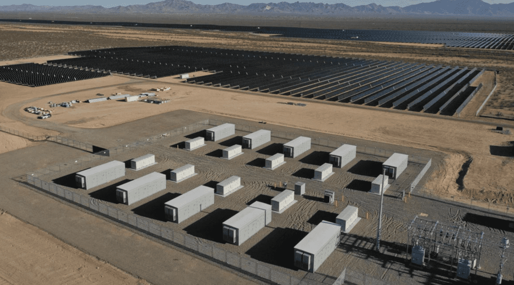

An Arizona utility plans to build a battery energy storage system (BESS) that will help it store more of the region’s abundant solar energy, enabling the power to be used after the sun goes down.
Tucson Electric Power (TEP) in early October said it plans to start operating what would be the largest energy storage system on the utility’s grid by summer 2025. Construction of the project is expected to begin by the end of this year. TEP said its proposed Roadrunner Reserve system would have a 200-MW capacity, with storage capacity of 800 MWh.
TEP said it will own and operate the BESS. DEPCOM Power, based in Scottsdale, Ariz., will design and build the sysem. A filing with the U.S. Securities and Exchange Commission related to the project pegs the cost at $294 million. It will be sited near TEP’s existing Vail Substation. The BESS will use lithium-iron phosphate battery cells.
Tucson Electric Power said its Roadrunner Reserve battery energy storage system will store solar power for use during evening and nighttime hours. Source: Tucson Electric Power
“Roadrunner Reserve will help us maintain reliability as we ambitiously but responsibly expand our community’s renewable resources,” Susan Gray, TEP’s president and CEO, said in a news release. “This new system will be particularly important in helping us satisfy peak energy needs during the summer.” TEP officials said the utility plans to charge the grid-connected system in during morning hours, and in early afternoon during periods of peak sunlight. Power will be dispatched later in the day, during periods of peak power demand.
TEP at present utilizes 51 MW of energy storage capacity. The largest installation in the utility’s current fleet is a 30-MW system at the Wilmot Energy Center near Tucson International Airport. TEP in its 2020 Integrated Resource Plan said it would add as much as 1.4 GW of energy storage to its portfolio by 2035.

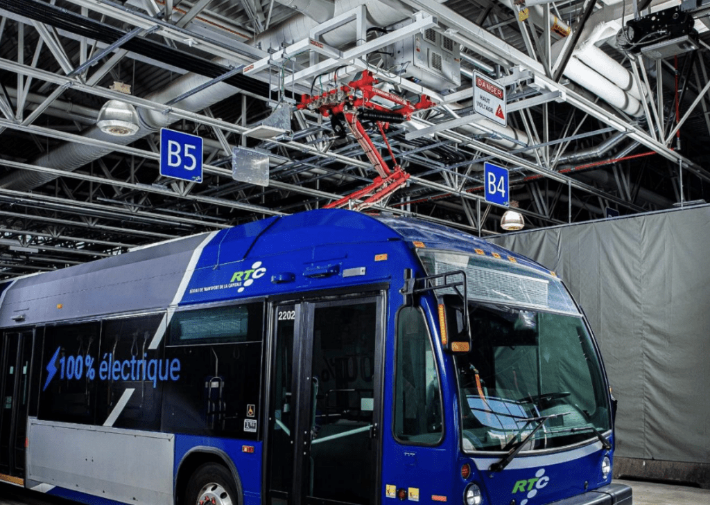

Hitachi Energy announced it has successfully deployed the first centralized EV bus charging system for Quebec City’s public transit agency, Réseau de transport de la Capitale, or RTC. The Grid-eMotion Fleet EV charging system powers an RTC pilot group of electric buses ahead of Quebec City’s shift to all-electric public transit. Officials said the project is a step toward total electrification for the transit group, with the pilot providing data on the best  strategies for charging large numbers of vehicles.
Hitachi Energy’s Grid-eMotion Fleet solution is an integrated charging system that can deliver multi-megawatt level charging capabilities. It is tailored to the requirements of urban bus fleets. Hitachi Enegy said the system requires 60% less space than conventional charging systems, enables a 40% decrease in required depot cabling. It already is in use for urban bus systems in London in the UK, along with Berlin, Germany, and Brisbane, Australia. The Quebec project supports the provincial government’s plan to electrify 55%of its urban buses and 65% of its school buses by 2030.
Quebec City’s transit agency is electrifying its entire bus fleet, with support from Hitachi Energy.  Courtesy: Claude Mathieu via Hitachi Energy
“Hitachi Energy is proud to support the RTC energy transition through our Grid-eMotion Fleet pilot deployment. This project offers a great opportunity to demonstrate how charging systems designed specifically for fleets can play a critical role in transitioning our urban transit systems to fully electric operations,” said Alireza Aram, managing director, Grid Integration North America for Hitachi Energy. “This exciting project is enabling us to explore different approaches to EV fleet charging in a real-world environment, gathering data that can be applied with public transit agencies around the world.”
