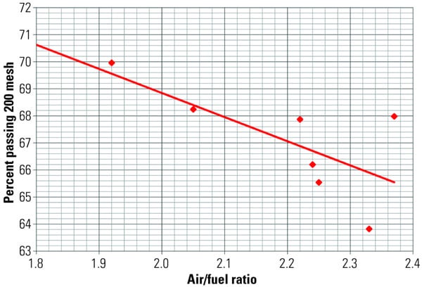

For example, following an MPS-89 pulverizer overhaul, the plant staff determined fuel fineness was poor. The principal reason was identified as high primary airflow, the most common cause of poor fuel fineness. The primary air/fuel ratio was at 2.3 pounds of air per pound of fuel. When the primary airflow was lowered to the optimum air/fuel ratio, fineness improved from a value in the mid-60% range passing a 200-mesh sieve to the mid-70% range.

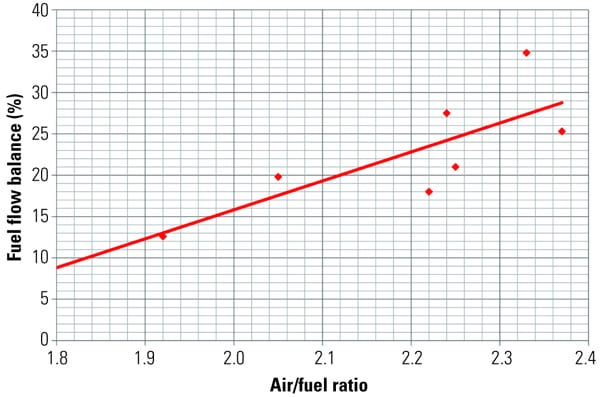

Undesirably high primary airflow not only contributes to poor fuel fineness but also to longer flames, increased fuel imbalance, higher CO levels, and higher peak flame temperatures at the superheater. Also, pockets of the products of combustion in a reducing atmosphere are often found in the upper furnace, which contributes to slagging when a fuel with high iron content ash is fired (Figures 2 and 3).
2. Pipe-to-pipe fuel flow balance. The test data illustrate how minor coal pulverizer and primary air/fuel ratio adjustments often result in a dramatic change in boiler performance. Source: Storm Technologies Inc.
3. Effect of excess primary airflow on fuel fineness. At this plant, reducing primary airflow improved fuel fineness and reduced undesirable combustion losses in the boiler. Source: Storm Technologies Inc.
