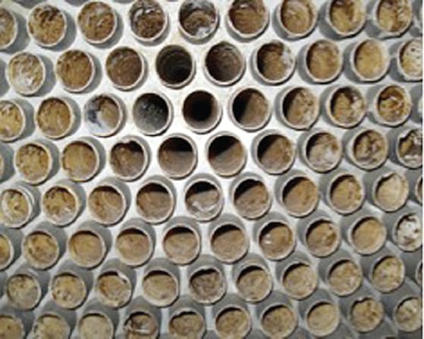

The steam surface condenser was inspected May 18, 2010. A beige patchy hydrated deposition that increased in degree of accumulation from inlet to outlet was noted on the surface of the stainless steel supply (first pass) set of tubes. An underlying whitish dust/salt-like coating was also present on the stainless steel tube surface and was more evident closer to the inlet that had little coverage of the beige hydrated overcoat material. The same white material was noted on the stainless steel coupon pulled for microscopic inspection. The degree of accumulation on the coupon was far less, but the same morphology existed as compared with the boroscope photographs of the first-pass inlet condenser tubes.

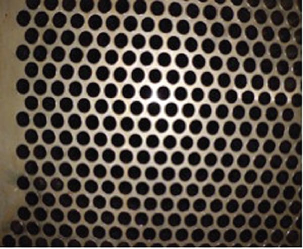

Figure 1 shows the condenser in its “as-found” condition. Figure 2 shows the cleanliness of the condenser after the water treatment system discussed below was placed into service.
1. Before treatment. Source: Ashland Water Technologies
2. After treatment. Source: Ashland Water Technologies

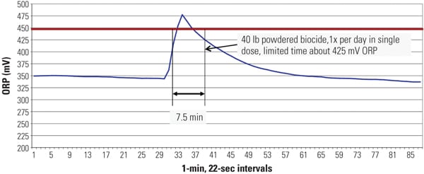

4. Too little time. A single daily chemical feed resulted in insufficient time at elevated ORP for adequate microbiological control. Source: Ashland Water Technologies
As part of the new treatment program, Ashland recommended feeding a series of three 20-pound doses of the powdered oxidant at approximately 8-minute intervals, which allowed the ORP to remain above 425 mV for over 30 minutes, as shown in Figure 5. The microbiological dip slides improved from over 106 CFU/mL to below 103CFU/mL.

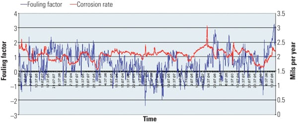

During the transition, corrosion rates remained below the target of less than 3 mils per year (mpy) and the fouling factor remained very low, as shown on Figure 6. All other operating parameters were met, and the target metrics established by the customer were satisfied.
6. Hitting the target. Key performance indicators of corrosion rate and fouling factor both remained below established targets. Note that the general trend in predicted corrosion rate is similar to that of the fouling factor. Source: Ashland Water Technologies

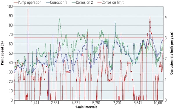

The best example of the usefulness and effectiveness of performance-based monitoring and control is shown in Figure 7. While the corrosion inhibitor chemical was base fed according to preset control ranges on a feedforward blowdown signal (see Figure 1 for visual results), the proprietary feedback loop system monitored the actual corrosion rate in real time and adjusted the corrosion inhibitor feed accordingly, based upon that KPI.
7. Good predictor. The chemical inhibitor pump adjusts the dosage automatically, showing excellent correlation with the real-time corrosion rate. Source: Ashland Water Technologies

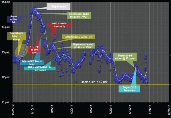

Shortly after transitioning to the new, improved cooling water treatment program, the condenser was mechanically cleaned according to the routine maintenance schedule and also as a performance enhancement measure. About two and a half weeks later, the online ORP analyzer indicated that the powdered oxidant failed to feed into the cooling system. This prompted plant operating personnel to tie the output ORP signal from the monitoring unit into their distributed control system and to set up an alarm feature for the control room operators.
However, the failed oxidant feed preceded a gradual rise in pressure drop (DP) across the waterbox of the condenser, indicating that a biofouling condition was building. Stainless steel mesh coupons confirmed the biofouling contamination. A proprietary biopenetrant was recommended, at an initially high shock dosage, to improve operating efficiency.
The biopenetrant product contains a low-foaming surfactant and a dispersant for the released biomass, but it is also particularly effective on silt and dirt debris. Silt, as well as biofouling, had been identified as a deposit on an earlier condenser inspection report. The appearance of the cooling tower itself markedly improved within 24 hours. All wetted surfaces that had been covered with slime were virtually clean, and the DP across the condenser waterbox began to decline.
A follow-up maintenance dosage of the biopenetrant was administered a few weeks later and, although the DP continued to fall, it still had not returned to the level it had been immediately after the mechanical cleaning and before it began to rise. The plant engineer noticed the DP reached a plateau and then rose again, so a second elevated shock dosage feed was performed. The results were remarkable and were directly associated with the removal of accumulated biomass and organic debris.
The biomass was also an excellent medium for capturing any other suspended material that may have been present in the cooling tower circulating water, such as silt and dirt, which were released immediately following the biopenetrant feed. This was evidenced by a large amount of visible suspended solids in the tower sump and a brown appearance to the water; it was also confirmed by a drop in ORP that remained well below the previous background value of about 325 mV for a number of days before eventually recovering.
The power plant made some mechanical changes to bring the system back to as steady a state as possible and to eliminate any variables, and the DP remained at the levels observed just after the mechanical cleaning (Figure 8).
8. Evidence of cleanliness. Removal of biofouling from the condenser using a biopenetrant was successful, as shown by a drop in waterbox differential pressure. Source: Ashland Water Technologies
