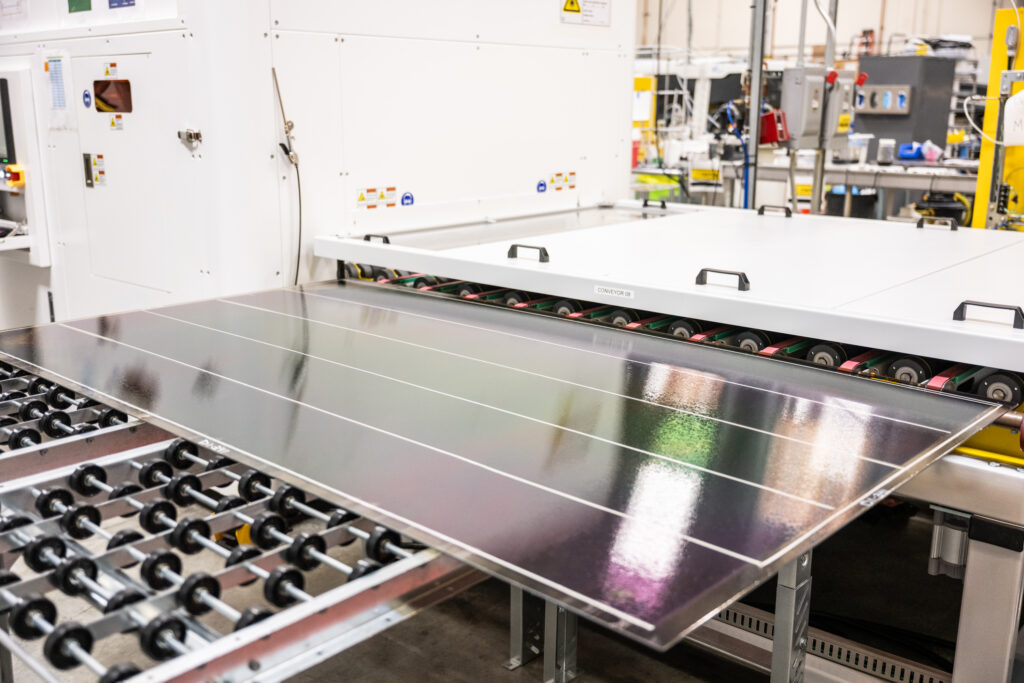

Increasing module efficiency is the best strategy to counteract rising land and component costs and mitigate tariff impacts. Today, in the laboratory, tandem technologies such as perovskite/silicon (Figure 1) are achieving efficiencies much higher than traditional silicon solar modules. As these technologies come to market they will provide significant benefits.
1. This image shows the Caelux perovskite Active Glass coming off pilot fabrication line in Baldwin Park, California. Source: Caelux
