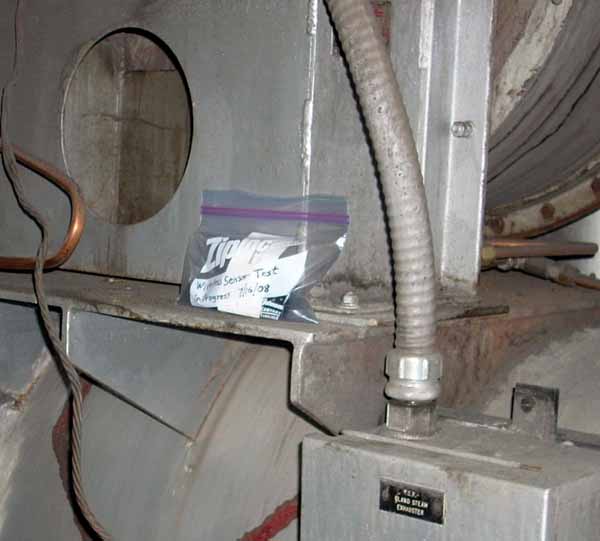

Twelve motes were distributed around the area under the Unit 5 turbine. This area has many large steam pipes and structural steel elements that have the potential to obstruct the radio signals from the wireless sensors. In most cases, there was no clear line of sight between motes. Because the test was planned to last only a couple of months, the motes were placed in plastic Zipock bags to protect them from dust and water (Figure 2).
2. On location. Because the test was planned to last only a couple of months, the motes positioned on plant equipment for wireless sensor network testing were placed in plastic Ziplock bags to protect them from dust and water. Courtesy: Southern Co.
The wireless sensor network equipment was powered up, and within about 15 minutes most of the motes were communicating with the base station. A mesh network was established, and all but two motes were able to communicate with the base station either directly or through the mesh. When the two noncommunicating motes were relocated slightly, they began communicating. The motes were left in these locations for several weeks. Sensor data and mesh network performance data were recorded continuously during that time.

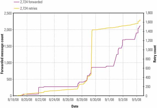

The mesh network software provided by the vendor provides the ability to monitor the mesh network performance and log the results to a file. One use for this functionality is to determine when the network connectivity or transmission quality changes. Two of the many parameters that are logged by this function are the number of messages forwarded by a node and the number of times a node retries to send a message. If the network configuration never changed and the transmission quality did not change, then the number of messages forwarded by each node would increase linearly over time.
If the mesh connectivity changes, then some nodes may forward more or fewer messages than in the original configuration. Similarly, if the transmission quality degrades, it may be necessary for a node to try several times to send a message before achieving a successful transmission. The multiple retries increase the overall network traffic and therefore the number of forwarded messages as well. Figure 3 shows one particular node that was on the edge of the mesh and farthest from the base station. It is clear that a disruption of communication occurred on August 29.
3. Living on the edge. The one particular node whose data are presented here was on the edge of the mesh and was farthest from the base station. It is clear that a disruption of communication occurred on August 29. Courtesy: Southern Co.

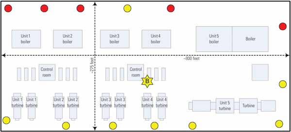

In an effort to determine the maximum transmission range of the wireless motes in a plant environment, a mote was moved around the plant while its communication to a base mote was verified. The base mote was located just outside the control room, as shown by the yellow star on Figure 4. The other mote was moved to the locations marked by the yellow and red circles. At each location communication with the base mote was checked. All the locations in this test were on the same level, elevation 424 feet. The radio power was tested at its maximum of 3 dBm (2 MW) and again at 0 dBm (1 MW). The movable mote successfully communicated with the base mote from all the locations shown by the yellow circles but did not communicate at the locations shown by red circles. It is clear that the radio signals can not communicate around the large boiler furnace obstruction.
4. Can you hear me now? This diagram shows the testing locations used to determine the range of wireless motes. Red circles indicate no communication with the base mote (the yellow B); yellow circles indicate successful communication with the base. Courtesy: Southern Co.

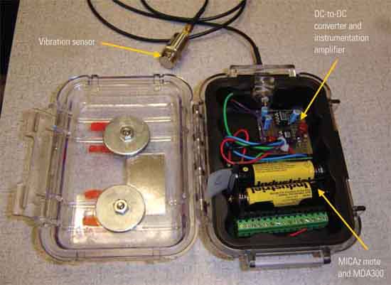

The Type-2 vibration-sensing node was designed using an external vibration probe with a magnetic holder that could be attached to locations where the Type-1 vibration-sensing node enclosure would not fit (Figure 5).
5. Vibration sleuth.
The Type-2 vibration sensor is equipped with an external sensor, a custom sensor interface board, and a high-speed sampling mote. Courtesy: Southern Co.
This node was equipped with the following components:
  • External vibration sensor. An external piezoelectric device originally used with a commercial, handheld vibration meter.
  • Custom sensor interface board. Piezoelectric sensors are high-impedance devices, and they must be interfaced with signal-conditioning circuits that have high input impedance. A custom interface board was designed to match the high impedance of the sensor and transform the vibration signal to appropriate voltage variations for the data acquisition board.
  • High-speed sampling mote. The data acquisition board performed two functions. First, it was used to generate the DC power to activate the interface board at intervals of 15 minutes, when vibration samples were taken. Second, during the sampling period, it obtained 20 samples at intervals of 50 ms for obtaining the vibration intensity.
