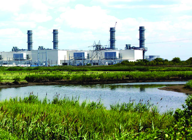

  • Linden Generating Station (Figure 1)—a 1,240-MW 4 x 2 plant in Linden, N.J., and the subject of this Top Plant profile.
1. Well worth the wait. The two-unit Linden Generating Station in New Jersey has a rated capacity of 1,240 MW at 94F. But when firing fuel in the winter, each unit can push 700 MW. You can clearly see from the perpendicular white buildings (the power blocks) in this aerial shot that one of the plant’s steam turbines is well off the centerline of the gas turbines. Also note the old steam plant (at right) and the limited site footprint. Courtesy: PSEG Power

The Linden site, just east of the New Jersey Turnpike in an area replete with petrochemical plants, didn’t provide a lot a room for the repowering project. The back side of the property is the Arthur Kill, the body of water from which the old plant drew its makeup water. It’s only about 40 feet from the new plant’s cooling towers, water treatment plant, and demin water storage tanks to the banks of the Arthur Kill.
The compactness of the site necessitated an unusual placement of the plant’s prime movers and unique piping geometry as well. In a typical 4 x 2 plant (where there’s enough room), the two gas turbines (GTs) and one steam turbine (ST) of one power block and the two GTs and one ST of the other are all laid out in a row. At Linden, at one end of the centerline are two GTs and two STs (one in line and the other offset), with the two remaining GTs at the other end. In other words, the configuration is wide rather than long (as the orientation of the white buildings—the power blocks—in Figure 1 makes clear).
