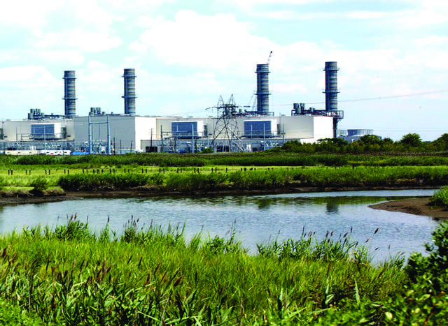

Linden Generating Station
Owner/operator: PSEG
New Jersey’s second-largest power plant has been a leader since it opened in 2006, when it was named a POWER Top Plant for its use of reclaimed water for cooling and for fitting an advanced four-unit facility into a constrained brownfield site. Now PSEG’s Linden Generating Station becomes a two-time Top Plant winner for its embrace of advanced digital monitoring and analytics to stay competitive in the red-hot PJM market.
Newark, New Jersey–based Public Service Enterprise Group (PSEG) has long been focused on staying ahead by offering reliable, low-cost power no matter the changes in its local markets. Its oldest subsidiary, Public Service Electric and Gas Co. (PSE&G), traces its roots to 1903 and has made its mark by embracing new technologies and aggressively leveraging them to serve its customers. In 2015, PSE&G was recognized as the most reliable utility in the Mid-Atlantic region by PA Consulting, a national industry benchmarking group—for the 14th year in a row.
In the late 1990s, PSE&G was one of the first generators in the new PJM Interconnection to embrace modern combined cycle generation as a key component of competing in the newly deregulated market. In 1999, the combined generation and distribution company was restructured as PSEG, and PSEG Fossil now operates some of the largest combined cycle power plants (CCPPs) in PJM, among them the 1,300-MW Linden Generating Station in Linden, N.J., which came online in 2006.
Though it’s located on the banks of Arthur Kill, across the water from Staten Island, N.Y., the 4 x 2 CCPP doesn’t use seawater—or any other local water resources—for cooling or makeup. Instead, it uses treated municipal effluent from the nearby Linden/Roselle Sewage Authority. That system was honored after the plant came online for reducing the site’s impact on the environment—the old thermal plant it replaced used ocean cooling—and for supporting operations at the sewage authority: Linden typically returns a portion of the purified effluent, which the authority uses to dilute its own discharge.
