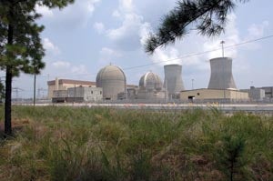

1. Peach of a plant. The Alvin W. Vogtle Electric Generation Plant is located on a 3,100-acre site along the Savannah River, 25 miles south of Augusta. Its two units entered commercial service in the late 1980s and together produce over 2,200 MW. Courtesy: NRC

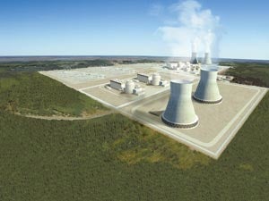

2. Twins. Southern Nuclear is moving forward with plans to build two new AP1000 Generation III+ nuclear reactors at Plant Vogtle. The two new plants are expected to enter commercial service in 2016 and 2017. This artist’s concept drawing illustrates the placement of the two new units in the foreground with the two existing units in the background. Courtesy: Southern Nuclear

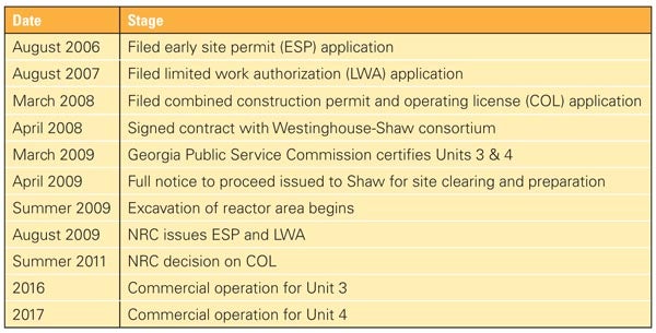

Table 1. Timeline for Plant Vogtle Units 3 and 4. Source: Southern Nuclear

Southern Company’s schedule for the two new units at Plant Vogtle is reasonable and achievable (Table 1). The plan to proceed with building two new units at the Vogtle site was confirmed after achieving the following major milestones.
The NRC’s renewal of the operating licenses for Units 1 and 2 for an additional 20 years (completed June 2009). The renewal application was submitted on June 27, 2007. In June 2009, the NRC renewed the operating licenses for Units 1 and 2 for an additional 20 years. The new licenses for Units 1 and 2 will expire on Jan. 16, 2047, and Feb. 9, 2049, respectively.
The Georgia Public Service Commission’s (PSC’s) certification, required under Georgia law, that approved building two new reactors at the Vogtle site (completed March 2009). The PSC adopted a motion on March 17, 2009, allowing Georgia Power to recover the cost of financing the plant during construction. Both entities will jointly develop mechanisms to provide shared risk protection to taxpayers from significant cost overruns. In addition, the Georgia Senate voted to allow the company to recover its financing costs during construction of the reactors, thereby saving customers about $300 million over time. The PSC agreement set Georgia Power’s portion of the certified cost of each of the new units at nearly $6.5 billion.
The NRC’s issuance of an ESP and LWA (completed August 2009). Southern Nuclear had submitted an Early Site Permit (ESP) application for the Vogtle site to the NRC on August 15, 2006, and an application for a Limited Work Authorization (LWA) on August 16, 2007. (See the sidebar for a complete explanation of the NRC licensing process.) The ESP application requested the NRC to approve a project site adjacent to the existing Plant Vogtle Units 1 and 2. The ESP and LWA were approved by the NRC on August 26, 2009. The ESP is valid for 20 years. The LWA allows a "narrow set of construction activities at the site," according to the NRC. In Southern Nuclear’s LWA, the company can start construction activities limited to the placement of engineered backfill, retaining walls, lean concrete, mudmats, and a waterproof membrane (Figure 3).
