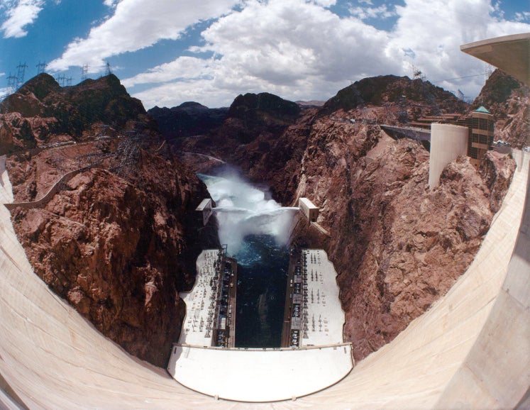

4. Finding its own level. Water levels at Lake Mead have dropped to 1,099 feet mean above sea level (msl)—and keep falling mostly due to surging water demand—but some existing turbines at the 2,080-MW Hoover Dam (shown here) will only operate efficiently in waters of more than 1,050 msl. The U.S. Bureau of Reclamation, the federal body that oversees hydropower production at the power plant, recently commissioned the design and manufacture of a new “wide-head” turbine runner for one of its generating units. The design could prove useful for several hydropower plants around the world, where water shortages have spurred chronic energy crises. Source: Bureau of Reclamation
