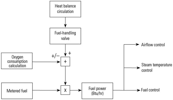

The FBC is capable of multifuel operation because the control strategy includes a computation called the Fuel Power Compensator (FPC). The FPC was developed for the world’s largest biomass-fired boiler, Alholmens Kraft Power Station, a 240-MW unit operating in Finland since 2002. This unit can reliably burn any combination of biomass and coal. Its biomass is a combination of peat, bark, and wood residue. Coal is the backup fuel.
The continuous measurement of oxygen consumption by the actual fuel consumed and the boiler energy balance calculations are the essence of the FPC. Oxygen consumption is estimated by the excess air ratio and combustion airflow. Both computations are required because the energy balance calculation is based upon averages and is relatively slow, but it is very accurate. The oxygen consumption calculation is relatively fast, often taking milliseconds, but it has errors because of the transport delay from combustion to oxygen measurement. Combining the two measurements provides an accurate view of what is happening in the furnace in real time (Figure 2).
2. Best of both worlds. Some combustion control designs use airflow (as a proxy for oxygen flow) and an air/fuel ratio to estimate the energy entering a boiler—a process that is fast but error-prone. Others measure the actual fuel consumed—a slow but accurate approach. In combination, a much more accurate estimate of the energy entering the FBC boiler is possible. The Fuel Power Compensator computes the energy input by measuring oxygen consumption and mass balance. The result is used by the fuel control, airflow control, and steam temperature control loops. Source: Metso Automation

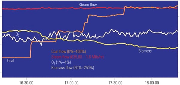

The FPC has been used on many multifuel boilers with excellent results. For example, Figure 3 is a strip chart of several performance parameters of the Alholmens biomass plant, which uses the FPC algorithms.
3. Well-controlled Nordic biomass plant. The 240-MW Alholmens Kraft Power Station is the largest biomass power plant in the world and burns a combination of coal and waste biomass fuels. The plant uses the Fuel Power Compensator (FPC) to optimize FBC boiler performance. In this recording, the operator is manually adding coal in 10% to 15% steps while the fuel control is responding to the FPC and driving the biomass flow downward to maintain constant energy output. Note how the steam flow remains unchanged during the fuel split change. Source: Metso Automation

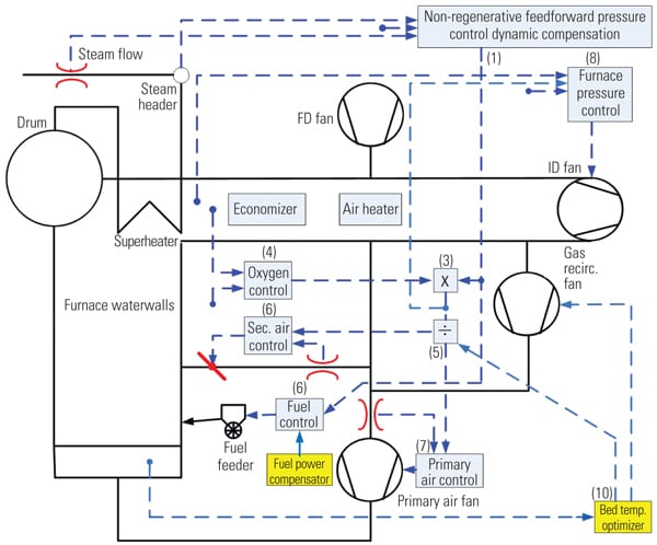

Figure 5 provides an overview of the basic controls used on a typical FBC boiler. The load is controlled by the steam demand in the form of a non-regenerative feedforward based upon steam flow, steam header pressure, and steam header pressure setpoint. These are incorporated in the boiler demand calculation that includes dynamic compensation, a requirement for AGC. While the boiler integrates the difference between the energy input and energy output of the boiler, the pressure error is primarily only a proportional process. The long FBC boiler time constant does not permit pressure control to operate as an integral control. The change in boiler demand is due primarily to the change in the feedforward. Other changes to boiler demand result from fuel quality changes.
5. Basic FBC boiler controls. This is a typical control strategy for an FBC boiler with a gas recirculation fan. If a steam turbine is connected to the header, a more complex demand computation involving the steam turbine first-stage pressure and steam flows is employed. The biggest difference between this control system and that used in a conventional solid fuel–burning plant is the bed temperature and fuel feed control loops. In this design, the fuel demand signal goes to the fuel feeder control (11) and the airflow control (3), where excess air is used to trim airflow demand to the secondary air control (6) and the primary control (7). The ratio of secondary to primary air is set by the operator or the optimizer control (5). The induced draft fan controls furnace pressure according to a feedforward from the airflow demand (8). Bed temperature control is maintained by recirculating flue gas into the bed. The flue gas tends to slow combustion and reduce the bed temperature. Source: Metso Automation

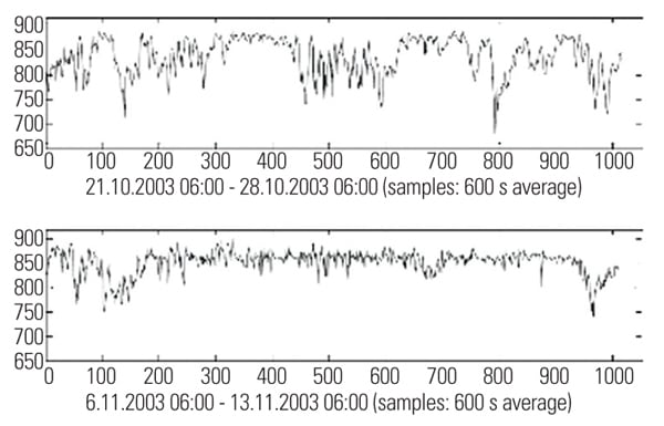

6. Fuzzy logic the clear winner. The objective of advanced bed temperature control is stable bed temperature. In this FBC boiler test, the average bed temperature recorded during a one-week reference period (upper line) is compared with the performance of the same FBC during another one-week test period, but running with advanced bed temperature control algorithms (lower line). Source: Metso Automation
The most unique control loop associated with a FBC boiler is the bed temperature. The bed is composed of many tons of hot sand and ash that is fluidized by primary air. The fluidization process is very important to the control of emissions and to minimizing limestone consumption in a coal-fired FBC. Furthermore, bed temperature is a function of fuel quality and changing boiler load because it is a function of the thermal balance of the bed. This is perfect for the application of a fuzzy logic controller, which is outside the scope of this article. Nevertheless, it can be said that these advanced control functions work extremely well in a biomass plant where the fuel constituents and moisture content are unpredictable (Figure 6).
