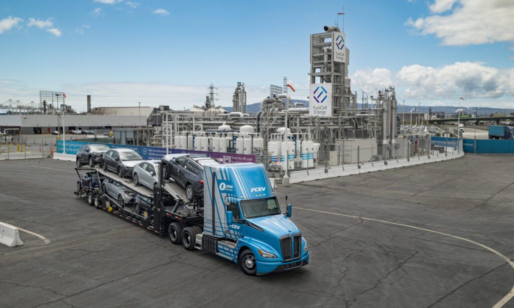

Another interesting project began operation in Southern California recently. FuelCell Energy and Toyota Motor North America Inc. celebrated the grand opening of the first-of-its-kind “Tri-gen” system at the Port of Long Beach on May 2. Tri-gen uses biogas to produce renewable electricity, renewable hydrogen, and usable water. It was built to support the vehicle processing and distribution center for Toyota Logistics Services (TLS) at Long Beach (Figure 1), Toyota’s largest North American vehicle processing facility, which receives approximately 200,000 new Toyota and Lexus vehicles annually.
fuel-cell-energy
1. FuelCell Energy’s Tri-gen technology produces three products: renewable electricity, renewable hydrogen, and usable water. Both light-duty and Class 8 heavy-duty fuel cell electric vehicles have been fueled using Tri-gen generated renewable hydrogen. Courtesy: Toyota Motor North America
“We have a system that in addition to producing electricity, also produces hydrogen that they use to fuel those vehicles and it also produces water they use to wash cars,” Leo explained. “So, that’s an example of a new application of fuel cell technology that’s very different.” TLS Long Beach is Toyota’s first port vehicle processing facility powered by 100% onsite generated renewable electricity.
