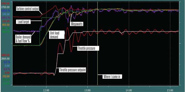

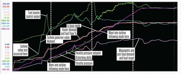

Figure 2 plots the data taken during start-up of a 320-MW power plant. At the lower left corner you can see where the valve transfer occurred. The valve transfer is a process in which the turbine, upon start-up, transfers control from the stop valve to the governor valve. There are actually two sets of valves in the main steam line before the turbine: the main stop valve and the governor valves. The next interesting point on this figure is the area that I call the "disturbing delta." There was a long period, during this load ramp, when the difference (delta), between the throttle pressure and the throttle pressure setpoint was virtually constant (the purple and green lines at the first vertical white dotted line). When we expect the controls to act one way, and they do not, it’s time to investigate.
2.    Under control. Taming a control loop that switched out the integral control on a load ramp. Source: Tim Leopold
During a change in unit load demand, in coordinated control, it is common practice to decrease the integral action of the boiler master controller to zero until the load ramp is finished. This strategy was used in all of the turbine and boiler master controller modes. This is a case where more is definitely not better; there was a touch of feedforward, based on boiler demand, substantial proportional gain, and no integral gain when I looked at the logic. Tuned as it was, the error signal between throttle pressure and throttle pressure setpoint will never go away.
I tried to tune out the error without success. Although the error decreased, as shown in Figure 2, we soon discovered that the tuning was not robust under all operating conditions. We then downloaded the necessary logic modifications (the second white vertical dotted line), causing the unit to drop out of turbine-following and into base load mode, and then back again. When the logic modifications were made, from that point on (the third white vertical dotted line) you can see good control of the throttle pressure. This is how a well-tuned turbine-following mode should operate.

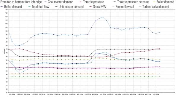

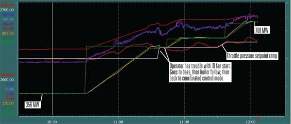

The tuning process can’t be rushed and does take some time to get right. Here is an example. Recently, I walked into the control room of an 800-MW unit just as the operators made a load change. As you can see, the response of the unit left something to be desired (Figure 3).
3.    Unresponsive.
A load change on this 800-MW unit showed poor response and controls in need of a good tuning. Source: Tim Leopold
By the third day, the coordinated controls were responding well after I slightly decreased the integral and proportional gain and increased the derivative action of the controller by about 25%. I also modified the feedforward signal slightly. Figure 4 illustrates the unit response to a 353-MW load increase test. About halfway through, the operator was unable to start an induced-draft (ID) fan, so he changed to base mode and then to boiler-following mode. When the ID fan was finally started, he returned to coordinated control mode. As you can see in Figure 4, a request was received by the front end to increase load just after the operator decided to raise his throttle pressure. This well-tuned boiler sailed through each test with rock-solid performance.
4.    New lease on life.
The same 800-MW unit as in Figure 3 showed much better response to a load change after tuning the proportional and integral gain and increasing the derivative action of the controller by 25%. Source: Tim Leopold

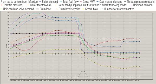

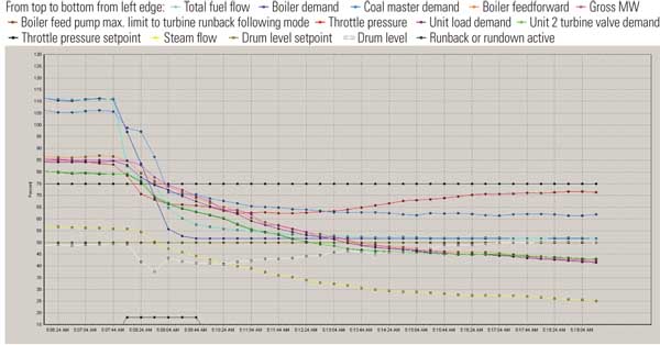

The data shown in Figure 5 were collected during an actual runback test on a 95-MW plant that operated with three pulverizers. The runback occurred when an ID fan was tripped, which had the effect of tripping one of the FD fans. The runback of the boiler was set to a point that was below the three-mill minimum load for safe and stable operation. As a result, automatic mill tripping on a runback was developed.
5.    Avoiding unit trips.
A runback test is necessary when any changes are made to boiler gas pass, fans, or mills. In this test of a 95-MW unit, the runback occurred when an ID fan was tripped. Source: Tim Leopold
You can see the boiler demand dropping, and the fuel flow percentage dropping even further as one of the three mills is shut down by the runback logic. The pulverizer master (coal master demand) picks up momentarily as the mill is stopped, then ramps back down, eventually getting the fuel percentage down to the boiler demand. Automatic mill tripping is generally a good idea, especially on larger units with a lot of mill capacity. Also, notice how the turbine pushes the throttle pressure back to the setpoint. Drum level also dropped slightly before it recovered. The entire runback occurred in just over two minutes. Figure 6 is a longer view of the entire episode.
6.    Many moving parts. The same runback test (Figure 5) of a 95-MW unit but with a longer time-span is illustrated. Here you can see the pulverizer master ramping back and the lowering of the turbine operating pressure setpoint. Source: Tim Leopold
In this test, as is true for most of the tests I have run over the years, the fan and fuel runbacks are easily handled by the turbine-following runback logic. However, the boiler feedwater pump runback can be another matter. The turbine valves are relatively slow to respond and tend to suck steam from the drum. Though some boilers are able to survive this without tripping on low drum level, many can not.

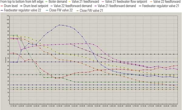

If you plan to test your runback logic, it’s a good idea to elevate the drum level a few inches before your test. At this same 95-MW plant, we tested the boiler feedwater pump runback using separated runback logic from 75% load with the drum level rundown initiated when the runback was complete. Figure 7 data illustrate this successful test from the feedwater perspective. Notice the action of the feedwater control valve. The drum level dropped about 6.5 inches. The low drum level trip was set at 7.7 inches. That was successful, but a little too close for comfort.
7.    Different perspective. The same runback test (see Figure 5) of a 95-MW unit but from the perspective of the feedwater system. Note the drum level response. Source: Tim Leopold
