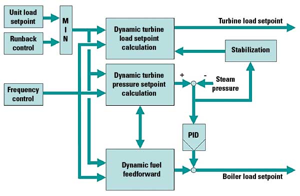

Figure 2 illustrates the typical way of controlling main steam pressure with a model-based feed-forward approach by adjusting the fuel mass flow. During load changes—load ramps as well as frequency disturbances—the required dynamic change in fuel flow, including necessary overfiring, is calculated by the incorporated models to achieve the desired dynamic unit response. The setpoint for pressure is dynamically adjusted in accordance with the calculated fuel demand so that the PID pressure controller will have no control deviation in the event of undisturbed unit operation. The pressure controller only intervenes in the event of disturbances.
2. Unit control concept with model-based feed-forward structure. Source: Siemens AG
Using a stabilization structure, the load setpoint of the turbine controller is adjusted as a function of the control pressure deviation from setpoint. For example, in the event of a main steam pressure that is too low, the turbine supports the pressure by throttling the HP valves. In this way, the boiler becomes an actuator for a self-stable control plant. However, every pressure control deviation that occurs will also result in a deviation of the electrical power from its setpoint.

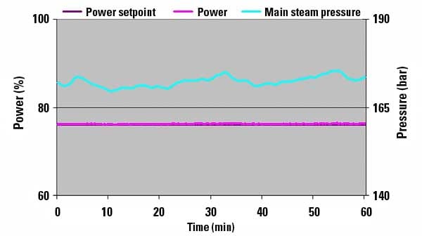

3. Control performance with model-based feed-forward structure—steady state case. Source: Siemens AG

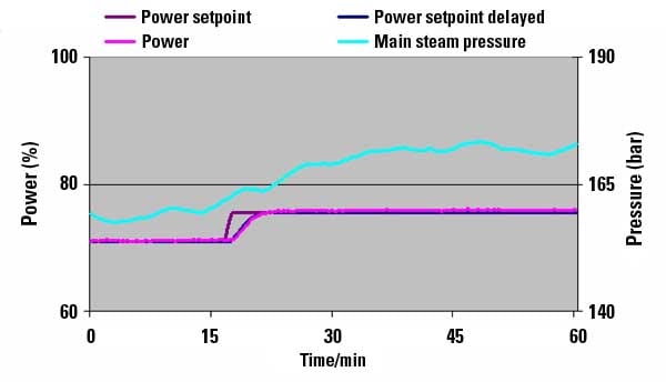

4. Control performance with model-based feed forward structure—load ramp case. Source: Siemens AG
The performance that can be achieved with a conventional unit control can be accurate, stable, and reproducible as long as the calculated trends for the fuel mass flow and main steam pressure are close to the real dynamic response of the boiler. Therefore, it is important that this data is incorporated into the controls system during commissioning to ensure that the dynamic model parameters are accurately determined. Determination of the model parameters must be carried out separately for load ramps, frequency disturbances, pressure setpoint changes, and so on. A great deal of testing may be required during commissioning to determine these model parameters.
With respect to the trends shown in Figure 4, we should note that German power plant units are typically operated with a natural S-curve for normal load ramps. This means that with an increasing load setpoint, the fuel flow is increased. The load setpoint of the turbine is increased once the additional fuel flow results in increased steam production. Therefore, there is no initial pressure drop, and the boiler can be operated smoothly. The APC-based unit control concept is applicable in the same way for unit operation with undelayed load ramps.

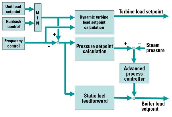

The APC-based unit control concept for main steam pressure control (Figure 5) can be differentiated from the conventional unit control approach in several important ways:
  • The APC is able to fully stabilize the non-self-stable loop. Therefore, it is not necessary to use the steam turbine to help stabilize steam pressure. The stabilization structure, which modifies the turbine load setpoint as a function of the pressure control deviation, can be omitted. As a result, the electrical load will follow its setpoint with a very high accuracy.
  • The APC can be used as a full-pressure controller without encountering any stability issues. Dynamic tracking of the pressure setpoint in case of load changes or frequency disturbances is not necessary. For this reason, determination of the corresponding model parameters is no longer required. In comparison to the conventional control concept, the commissioning time for an APC-based controller is reduced drastically.
  • There is no need to perform a dynamic feed-forward calculation for the required overfiring. Only a static feed-forward calculation of the boiler load setpoint as a function of the steady-state unit load is performed. The required overfiring is determined automatically by the APC, which uses the pressure control deviation as an input value. Eliminating the testing required to determine these model parameters results in much lower commissioning and testing costs.
  • Only a boiler time constant and steam storage time constant are required by the APC. The APC is very robust in terms of these parameters so that a highly accurate measurement is less important.
5. Unit control concept with APC. Source: Siemens AG

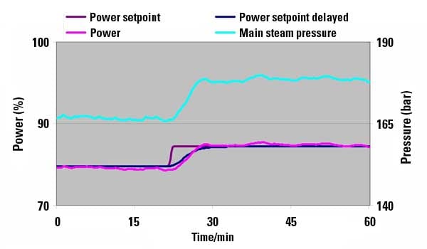

7. APC-based unit control performance—load ramp case. Source: Siemens AG

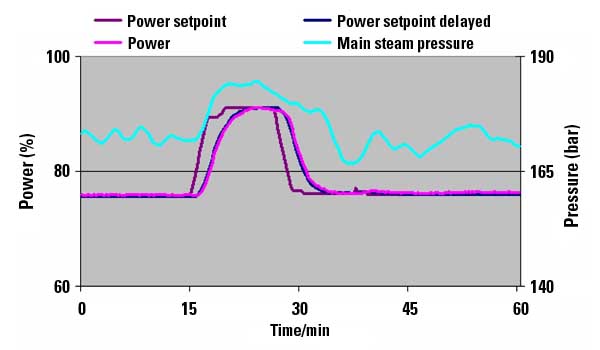

8. APC-based unit control performance—load change case. Source: Siemens AG

Figure 7 shows the control deviation for a load increase at a rate of approx. 4.5% per minute. Again, there was virtually no control deviation for the electrical load. Control performance, which was already very good before (Figure 4), was further improved.
The APC not only stabilized the main steam pressure but also handled the pressure increase experienced because the unit was operated in sliding pressure mode, as the higher load setpoint requires a higher main steam pressure. Comparing the test data with that in Figure 4 shows that the pressure increase was performed slower than before. However, this was not a question of the different control concepts used but a question of how quickly the commissioning engineer wanted the pressure setpoint to increase. When the APC structure was commissioned, it was decided to perform pressure changes slowly to allow smooth boiler operation.
Figure 8 illustrates how the unit responded when the load setpoint was increased and then reduced. The load change rate was approximately 5% per minute. The APC was able to quickly stabilize pressure, and the load followed its setpoint with a very high accuracy.
