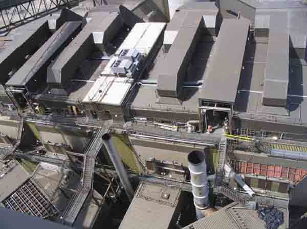

Otter Tail Power Co.’s Big Stone Plant Unit 1, located in Milbank, South Dakota, is a 475-MW plant that burns Powder River Basin (PRB) coal (Figure 1). This unit was originally outfitted with an electrostatic precipitator (ESP) when it was constructed in 1975. During the mid-1970s the number of ESPs installed on coal-fired boilers across the U.S. spiked in response to the Clean Air Act of 1970. The long-established technology of the ESP was at the time considered the best choice to meet the particulate emission requirements of the Clean Air Act.
1.    ESP upgrade needed. Big Stone Unit 1 elected to use the casings of its electrostatic precipitator (ESP) to house a pulse jet fabric filter. The upgrade not only ended unit derates for opacity excursions and induced draft fan pressure drop limitations, but the new equipment also performs well enough to meet anticipated future fine particulate matter legislation. Courtesy: Buell APC
Many of those original ESPs are now candidates for an upgrade or replacement to meet the latest emissions and opacity requirements. The precipitator’s collection efficiency can be maintained within the normal variations in boiler operation, but its performance is sensitive to the electrical characteristics of the fly ash as defined by the type and source of the coal burned. Many of these "first-generation" ESPs have been rebuilt with new and improved plate and emitting electrode systems, power supplies, and control systems to extend their life. Others cannot meet current outlet emissions and stack opacity rules, so plant owners face eventually replacing their aged ESPs with a pulse jet fabric filter (PJFF).
At Big Stone Unit 1, a different and more cost-effective alternative was selected: Buell APC was retained to replace the existing ESP with a PJFF configured to fit within the ESP casing. After overcoming the inevitable challenges that occur when putting a square peg in a round hole, the conversion was completed in late December 2007. These challenges were plant-specific, but many, as you will see, also apply to other utilities that might be considering similar projects.

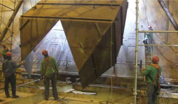

The ESP chambers had been partially converted to a pulse jet with the prior retrofit of the AHPC equipment. The walk-in outlet plenums, vaned outlet dampers, and outlet ductwork installed with the AHPC retrofit were retained (Figure 3). The precipitator plates and emitters, support channels, rappers, bags, cages, and tubesheets from the hybrid design were removed from each ESP chamber. Also, the gas-flow baffle plates were removed from the inlet pyramidal nozzles.
3.    Keep the best, out with the rest. The AHPC retrofit technology walk-in plenums, dampers, and outlet ductwork were retained. The ESP and AHPC internal hardware and ESP external electric hardware was removed as part of the PJFF upgrade. The four separate chambers are shown with roof walk-in plenums and the long outlet ducts. Courtesy: Buell APC
After all internals were removed, new tube sheets were installed and supported by a shelf angle around the perimeter of each chamber. Three partition walls were installed in each chamber to compartmentalize each chamber into four pulse jet compartments. Each compartment uses off-line cleaning by closing off the existing dampers located on the roof of the outlet walk-in plenum.
No damper was added to the inlets of the compartments. An inlet transition duct with turning vanes was added to each inlet pyramidal nozzle that fed the gas flow to a pulse jet compartment inlet plenum that extended down the lower center of the chamber its full length (Figure 4). Gas flow entered each of the four compartments via a vaned opening on either side of the inlet plenum. The top of the rectangular inlet plenum has a peaked "roof" at the top to prevent buildup of ash from bag cleaning.
4.    New entry created. Each ESP inlet pyramidal nozzle duct was modified with turning vanes and transition duct to connect to a PJFF inlet plenum that extends the length of the chamber’s centerline. Courtesy: Buell APC

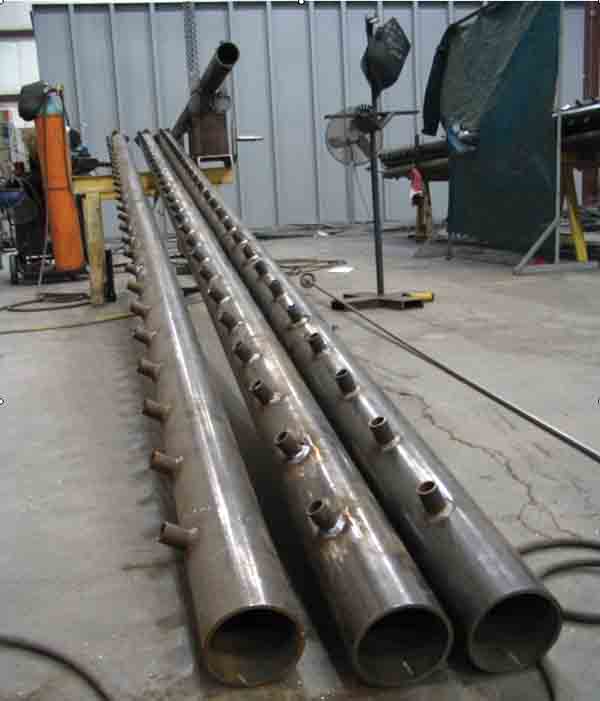

For bag cleaning, 32 completely shop-assembled air header assemblies were installed using a 4-inch solenoid valve for each blowpipe. Each row of 54 bags on each tube sheet has two blowpipe assemblies with 27 bags per blowpipe and 19 rows per compartment (Figure 5). The blowpipe pulse discharge hole size varies along the length of the blowpipe to ensure equalized pulse air cleaning volume to each bag. For access to the header assemblies and solenoid valves, three new platforms were installed: two outboard of the end precipitator chambers (with weather cover) and one under the existing control room located between the two pairs of ESP casings. A walkway was added with a new side access door for bottom access to each pulse jet compartment
5.    Ready for installation. These are three of the 608 required blowpipes in the fabrication prior to shipment to the Big Stone plant. A 4-inch solenoid controls the compressed air used by each blowpipe to clean the filter bags. A total of 608 pulse valves were used on the project. Courtesy: Buell APC

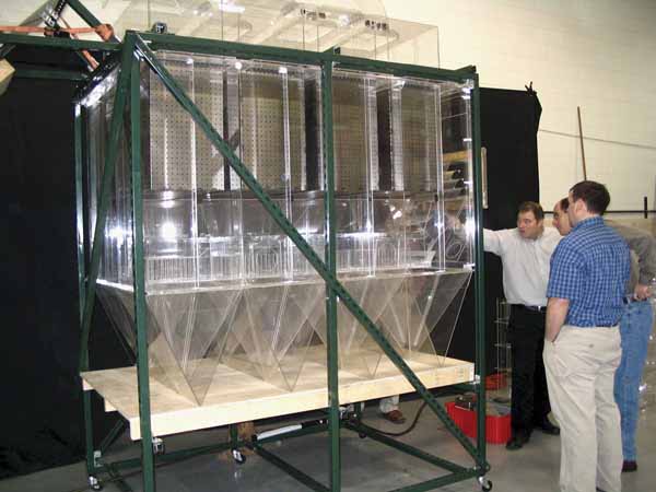

During the design phase, both a numerical model study and physical model study were performed on the PJFF flow configuration. To ensure optimum pulse cleaning of the 27, 25-foot-long bags on a blowpipe, blowpipe design and optimization laboratory tests were conducted by the pulse valve supplier.
Buell APC contracted Airflow Sciences Corp. to perform a flow model study to ensure that the new baghouse conversion configuration met the Institute of Clean Air Companies (ICAC) standards for flow uniformity. The flow study used both numerical and physical modeling techniques. The computational model of the Big Stone conversion scope was from the guillotine damper just upstream of the inlet nozzle to the ID fan inlets.
Numerical Model Study. The goals of the numerical modeling were to ensure that the flow split between compartments in a chamber met ICAC F-7 criteria (within ±10%) and to optimize gas flow distribution and minimize losses in the inlet transition to the fabric filter inlet manifold. The computational model found that the flow split between the four compartments in a chamber met the ICAC criteria, although several changes were made to the inlet transition vanes to further improve the flow distribution and reduce the flow losses below that of the baseline design.
Scale Model Testing. The goals of the physical modeling were to confirm the numerical modeling results, ensure that no significant ash buildup occurred in the ductwork and inlet manifold floor through dust deposition tests, and quantify the system pressure losses. The physical model testing was based on a 1/12 scale model (Figure 6). As the four chambers of the baghouse are identical, only a single chamber was modeled. The physical model scope extended from the inlet transition nozzle of the baghouse through the outlet ducts to the common duct that leads to the ID fan inlets.
6.    Computer-designed and model-tested. A numerical flow study confirmed that the flow split and distribution met ICAC standards and that the inlet design kept flow losses to a minimum. A 1/12 scale model of one of the four identical chambers of the PJFF was tested to confirm the computational modeling results. Courtesy: Buell APC
The results of the physical modeling showed that there was good agreement between the numerical and physical model results. Dust deposition tests confirmed that the majority of dust was swept clean from the inlet manifold floor at 75% of full load flow velocity and no significant buildup of dust was observed at 100% flow. The flow split between the four compartments was 23.1%, 22.8%, 26.6%, and 27.5% — well within predictions.
Blowpipe Design and Optimization Tests
Goyen Controls Co. Pty Ltd., Sydney, Australia, conducted blowpipe design optimization laboratory tests. A 27-outlet blowpipe was fabricated per Buell’s specification with additional pressure tap locations. Four-inch blowpipes and valves were selected to meet the pulse cleaning airflow requirements for 27 bags per blowpipe.
The goals of the blowpipe optimization tests were to determine the staggered pipe orifice sizes along the pipe that would provide equal pulse air volume to each bag (within ±10%); determine the optimum blowpipe air straightening nozzle diameter, length, and height above the tube sheet; and determine the air consumption required per blowpipe.
A clean filter bag is usually not very indicative of the cleaning performance with dust-laden filter bags when testing a blowpipe system. Rather than using clean filter bags, Goyan accurately simulated a dust-laden filter bag using a jet pump duct. A significant advantage of the jet pump duct is that it is possible to simulate a range of dust loadings by altering the position of the blast gate (altering the resistance to the pulse), thereby mimicking the varying dust loads on the filter bags. The jet pump duct is 3 meters long with a diameter of 150 mm. A blast gate is located 1 meter from the entry of the duct. A flow meter arrangement using an orifice plate is located at the exit of the duct. Pressure taps are located halfway between the duct entry and the blast gate. Test runs along the blowpipe outlets were conducted at 45 and 60 psi pulse pressure. A good distribution of cleaning flow along the blowpipe was achieved with cleaning flows within ±10% of the average, as designed.

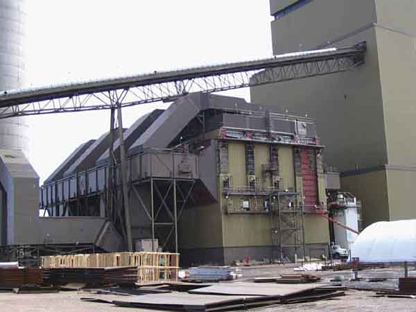

The outboard two ESP chambers were converted during the spring of 2007, one at a time, starting in early March. The first chamber was removed from service with a short outage for blanking plates to be installed in the chamber’s inlet and outlet rectangular ducts. The first chamber was converted during a six-week period, with the unit at reduced load, and started up in April 2007. Conversion of the second outboard chamber followed during another six-week period. Start-up of the second converted chamber occurred in June 2007. During the summer and early fall, the unit operated with the two converted pulse jet chambers and the two chambers with the AHPC design. The remaining two ESP chambers were converted to pulse jet operation during a scheduled late fall outage. The completed conversion was fully operational in December 2007.
All performance guarantees were met, including stack opacity and pressure drop. The stack opacity was close to zero, prompting Big Stone Plant to forego the outlet emission tests. In 2008, Big Stone Plant Unit 1 set a new annual generation record. Operating restrictions caused by opacity problems or ID fan pressure drop limits are just a memory.
