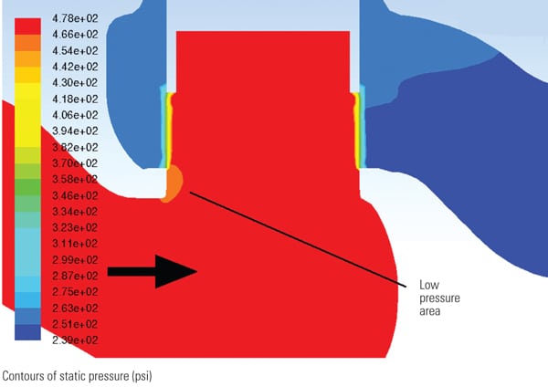

In applications incorporating an in-line globe valve oriented in the flow-to-open direction, the process fluid has to negotiate the turn as it approaches the valve trim. This produces a low-pressure region adjacent to the seat ring (Figure 2). The severity of the decrease in pressure depends on the valve geometry, fluid velocity, and fluid properties.
2. Undersized valve. A CFD pressure plot illustrates flow through an undersized valve oriented in the flow-to-open direction. Note the large low-pressure zone adjacent to the valve seat ring. Under certain conditions, this low-pressure region will detach from the valve body wall, enter the free stream, and form a free eddy. Source: GE Energy
Under certain conditions—when the pressure becomes low enough and the velocity is high enough—the low-pressure region will detach from the valve body wall, enter the free stream, and form a free eddy. These eddies are continuously created, even under steady state flow conditions, and are similar to the von Kármán street vortices shed behind a bluff body in a free stream.
The CFD pressure plots shown in Figure 2 and Figure 3 illustrate how these low-pressure areas can be formed. Each shows natural gas flowing through a valve. Both valves have the same mass flow and a pressure drop ratio of approximately 2:1. The valve in Figure 2, however, is undersized, while the valve in Figure 3 is adequately sized. In the undersized valve, flow velocity increases in the valve inlet, creating a large low-pressure area where detached vortices could form.
3. Adequately sized valve. A CFD pressure plot showing flow through an adequately sized valve oriented in the flow-to-open direction. Note the absence of low-pressure zones. Source: GE Energy
