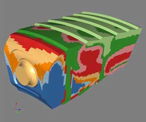

Step 2. Create an ERN from a CFD Solution. ENERGICO’s specialized software algorithms or user-customized algorithms and filter tools automatically capture the dominant flow patterns and recirculation zones from the CFD flow analysis (Figure 3). Representing the combustor with a series of idealized reactors allows the use of detailed chemistry within a reasonable amount of computational time.
3. Network solutions. ENERGICO defines zones (see Figure 1) based on the flow field, patterns, and recirculation zones that will then be used to define an equivalent reactor network (ERN). Once the ERN is created through a careful devolution of the combustor flow field, the fully detailed chemical mechanism can be used to develop an understanding of chemical behavior and performance inside the combustor. Source: Reaction Design
The first step in creating the ERN from a CFD solution is to divide the combustor flow field into zones that will then become reactors linked together to form the ERN. ENERGICO provides two prepackaged algorithms to create zones that will be effective in providing accurate simulation of trace emissions of NOx, CO, and UHC. One algorithm looks at the gradients of oxidizer, fuel, and temperature in the flow field and divides the flow field into zones that are set to perfectly stirred reactors by default. The other algorithm refines the reactor type for each zone by setting criteria for which zones would be more effectively represented as perfectly stirred reactors and which would be better modeled as plug flow reactors. Zones that are created in the combustor flow field are viewable. Figure 4 illustrates a relatively simple five-zone reactor; an actual combustor may have hundreds of reactors.
In addition to using the prepackaged algorithms, users have the ability either to refine the algorithms for zone creation or defining reactor types, or to create and save new, user-proprietary algorithms that are targeted to more-specific types of systems.

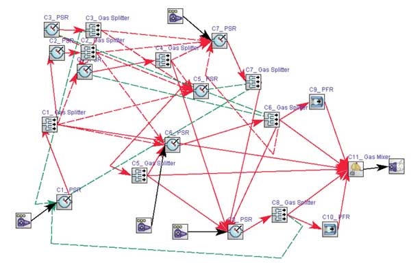

Once the ERN is created through a careful devolution of the combustor flow field, the fully detailed chemical mechanism can be used to provide an understanding of chemical behavior and performance. For this approach to be successful, however, it is critical that the ERN is a true representation of the actual combustor flow field. The simple five-reactor representation shown in Figure 4 is typically insufficient, because modern combustor designs are much more complicated, with multiple inlet, recirculation, flame-stabilization, and after-burn regions — and potentially hundreds of reactors.
4. Zoned out. The zones shown here may also be viewed as individual reactors in an
intricate network. At this point, the ERN can either be solved using the full detailed chemistry solution for the nominal conditions, or a parameter study can set up on the RN to introduce changes for further exploration of the system design. Source: Reaction Design

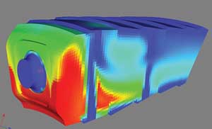

Step 4. Visualize the ERN Solution on the CFD Domain. It is helpful to view the ERN solution in relation to the combustor geometry and flow field to assist in the design process. ENERGICO provides the capability to view the ERN results on each of the zones within the combustor geometry. This provides a geometrical context that will facilitate identification of modifications to the combustor design that might improve performance or reduce emissions.
Once the solution has been completed, the results for each individual reactor in the ERN can be displayed, or they can be imported back into ENERGICO for overlay display on the combustor geometry.
Figure 5 is an example of this presentation of the ERN results overlaid on the geometry, highlighting the thermal NOx formation rate in each zone of the combustor. ENERGICO provides the ability to separate the thermal NOx formation rate from the total NOx formation rate by tracking the reaction paths that lead to thermal NOx formation. Other key ERN results — such as CO, NOx, UHC, volatile organic compounds, and the soot precursor PAH — can be viewed on the combustor flow field. For convenience, NOx and CO are automatically provided in dry ppm units, as well as dry ppm corrected for 15% O2.
5. Intuitive results. Here the ERN based on the nominal conditions of the original CFD case and display results of the ERN are overlaid on the combustor geometry. Source: Reaction Design

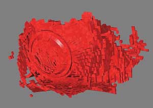

Step 5. Conduct an LBO Analysis. Lean blow-off is one of the most challenging combustion stability problems in low-NOx combustor design. LBO occurs when the heat generated by chemical reactions is no longer sufficient to ignite the incoming fuel/air mixture to sustain the flame. In low-NOx combustor design, the low-NOx limit is often bound by the onset of combustion instability in the form of LBO. Identifying the onset of LBO is critical in combustion system design. Because this condition is dictated by real chemistry and fluid dynamics, the reduced chemistry intrinsic to most CFD tools cannot provide the necessary accuracy.
The ENERGICO simulation package uses the well-documented concept of evaluating the relative time scales for chemical reaction and fluid mixing to predict when LBO will occur. In conventional uncontrolled combustors, the combustion is limited by the degree of mixing occurring within the combustor, as chemistry is typically much faster than mixing. However, as the flame temperature is decreased to reduce NOx, the chemical reaction slows to the point where temperature becomes the rate-limiting factor and the onset of LBO may be triggered (Figure 6).
6. Lighting a match in a hurricane. To help designers determine the propensity of their system to experience lean blow-off, the ENERGICO simulation package captures the specific region in the combustor flow field that represents the flame front based on the CFD solution. An analysis is then performed, using detailed chemistry and the CFD flow field, to evaluate the viability of a flame in that location. This image shows a simulation of a lean blow-off in progress. Source: Reaction Design
