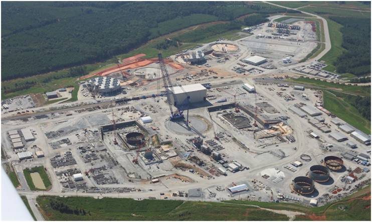

Westinghouse, the lead supplier for the V.C. Summer nuclear plant expansion project in South Carolina, said on August 30 that it had successfully placed the reactor vessel for the new Unit 2.
The 278-metric-ton vessel was rigged into place by one of the largest construction cranes in the world, a heavy lift derrick with a 560-foot front boom, plant owner South Carolina Electric & Gas (SCE&G) said (Figure).

The 278-metric-ton reactor vessel for V.C. Summer Unit 2 is rigged into place inside the containment building. Courtesy: SCANA Corp.
