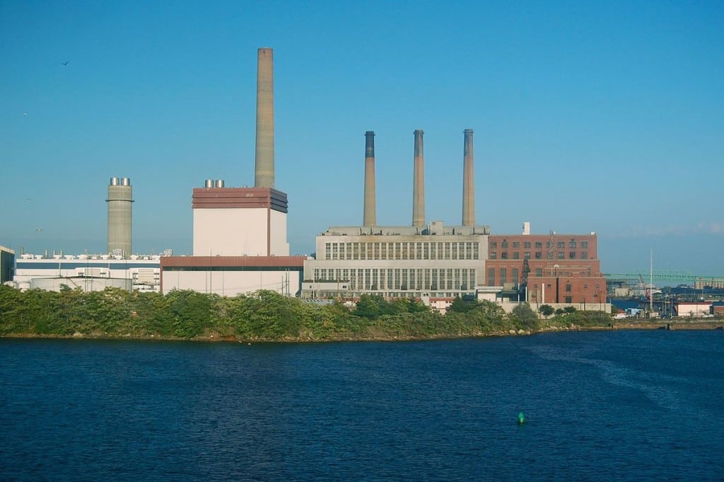

Exelon’s Unconventional Mystic Reliability-Must-Run (RMR) Contract
According to the authors, no single application could have as much impact on the future of energy markets as the one pending before the Federal Energy Regulatory Commission (FERC) regarding a tariff waiver request by ISO-New England (ISO-NE). Its intention is to keep Exelon’s 2,274-MW Mystic Generating Plant in Boston, Massachusetts, running to address “fuel security risks,” even though Exelon said in March it planned to retire the gas-fired plant when its capacity obligations expire in May 2022 unless it received a two-year RMR contract to recover full cost of service. Exelon later estimated it would need an annual fixed revenue requirement of about $219 million for capacity commitment period 2022/2023 and nearly $187 million for 2023/2024.
On May 28, most stakeholders filing comments with FERC opposed the request. They questioned ISO-NE’s plan to keep open Mystic 8 and 9—two combined cycle gas-fired units with a total winter seasonal capacity of 1,700 MW. The units get fuel from the Everett Marine Terminal, a neighboring liquefied natural gas import hub, rather than relying on pipeline gas.
ISO-NE on May 1 asked FERC to approve waivers by July 2. It said the loss of those units presents “unacceptable fuel security risks,” causing the ISO to deplete 10-minute operating reserves on numerous occasions, which could instigate load shedding during New England winters of 2022–2023 and 2023–2024. Shuttering the units would also mean that the Everett Marine Terminal (known as Distrigas), which Exelon is in the process of acquiring from current owner ENGIE North America, would lose its biggest customer, “substantially diminishing its financial viability” and putting the regional reserve depletion and load shedding at further risk, the ISO argued.
