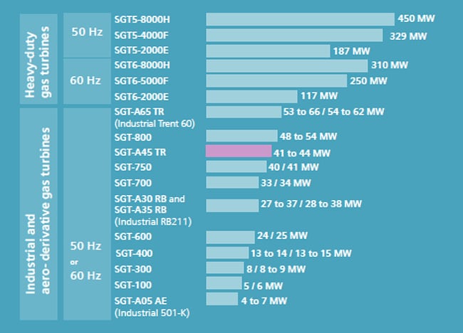

- A model list. Siemens’ gas turbine portfolio ranges from 4-MW to 450-MW turbine models. Heavy-duty gas turbines are “robust and flexible engines” designed for large simple or combined cycle power plants. Industrial gas turbines are smaller but rugged and compact, which makes them ideal for industrial power generation. Aeroderivative gas turbines, which were historically developed for use in aviation, offer flexibility, compact, and lightweight designs geared for high efficiency and fast-start capabilities. The newest offering, the SGT-A45, is a 44-MW aeroderivative gas turbine. Courtesy: Siemens

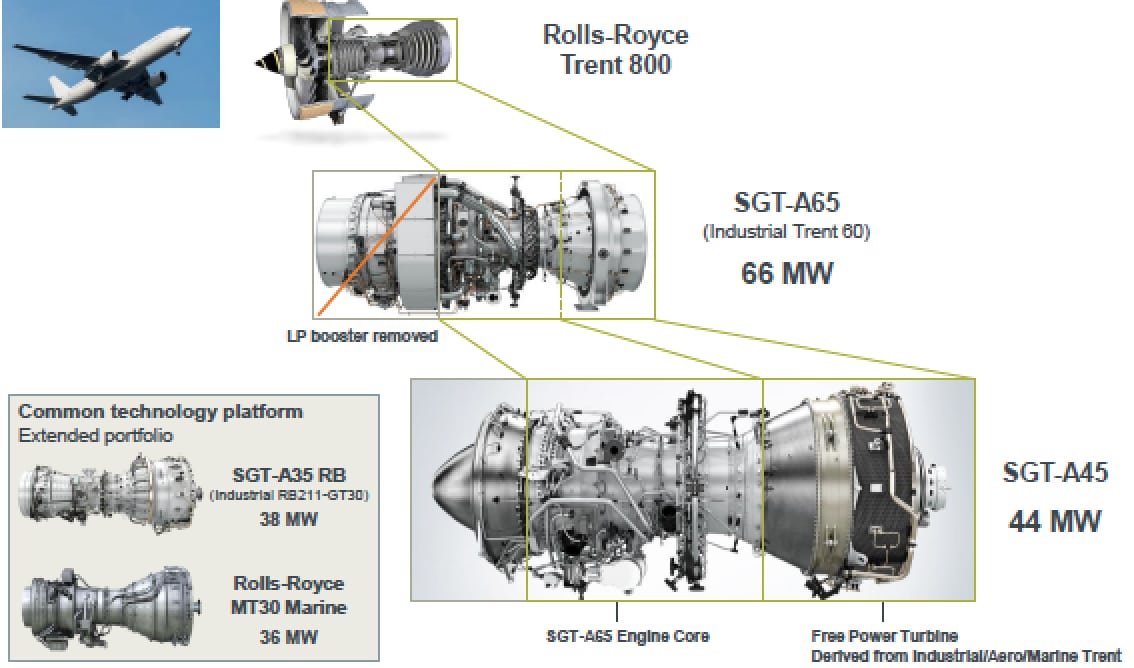

Developed over the past 20 months, the SGT-A45 TR derives directly from the SGT-A65 TR, a 66-MW model whose design was first released nearly 20 years ago, and in turn, was based on Rolls Royce’s Trent 800 aero-engine technology (Figure 2). The A65, formerly known as the “Industrial Trent 60,” was developed as a flexible, efficient, and high-cyclic capability engine, ideal for peaking applications, explained Brian Nolan, a Siemens SGT-A45 product manager on November 1. But while the A65 uses a low-pressure booster and three coaxial, independently rotating shafts contained within a carcass of axially joined circular cases, the A45 uses only two shafts as well as a free power turbine. It sheds the A65 low-pressure booster to keep it compact, he said.
- A Rolls-Royce pedigree. Siemens’ 66-MW SGT-A65 and the new 44-MW SGT-A45 aeroderivative gas turbine models derive directly from Rolls-Royce’s Trent 800 engine launched in 1996 and is often used in Boeing 777 Classic aircraft. LP stands for “low pressure.” Courtesy: Siemens

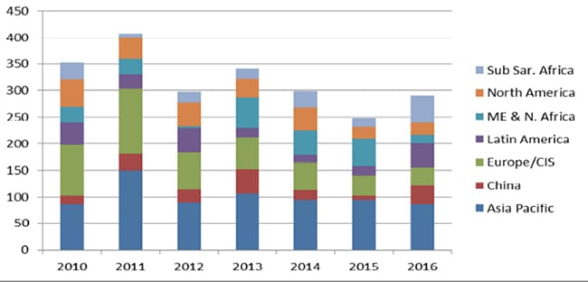

According to the company, gas turbines are becoming an important part of the world’s rapidly expanding distributed generation segment. Sales of gas turbines of between 3 MW and 66 MW—typically used in the industrial power generation market—have grown in spurts (Figure 4) owing to volatile oil prices and financial ups and downs, it says in a paper presented at POWER-GEN Europe in Cologne this summer. In 2016, Asia had the largest distributed power gas turbine market overall, led by Japan, which installed several small turbines of less than 6 MW for backup power. But Africa, Latin America, and China also saw “robust growth” last year, installing high-units in the 42 MW to 66 MW range. As could be expected, however, economic factors continue to depress market potential in North America, Europe, and Central Asia, it said.
- Small gas turbine (3 MW–66 MW) volume trends. This graph shows the last seven years of sales of all industrial and aeroderivative gas turbine products sold in the industrial power generation market by the world’s 12 major original equipment manufacturers. Courtesy: Siemens

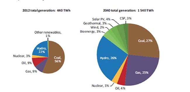

Africa—the second-fastest growing economic region in the world—has both high foreign direct investment and a vastly underserved demand for power, even as its large and diverse population soars and becomes more urban- and industrial-oriented. The continent is poised to see its greatest increase of power generation in the next two decades—and according to Siemens, based on emissions, efficiency, and environmental concerns, by 2040 Africa’s use of natural gas will increase by more than 800% to fuel a quarter of all the continent’s generation (Figure 5).
- Electricity generation by fuel, sub-Saharan Africa. Courtesy: Siemens/IEA
“Siemens intends to participate in Africa’s growth to 1,600 TWh [per annum] in 2040,” the company said. The African market displays a “more imminent need—to quickly improve the African power infrastructure by providing highly flexible solutions and fast order-to-execution projects in the form of small and medium-sized power plants,” the company said. “The combination of these diverse requirements calls for market and customer-specific solutions in order to truly answer Africa’s call for electricity.” Distributed generation with light industrial and aeroderivative gas turbines, in particular, makes sense for the continent’s needs because it allows for fuel flexibility, fast-response times, and low maintenance downtimes. “At the same time, they can help to optimize network operation by providing voltage support, or reactive power and inertia to a local grid.”

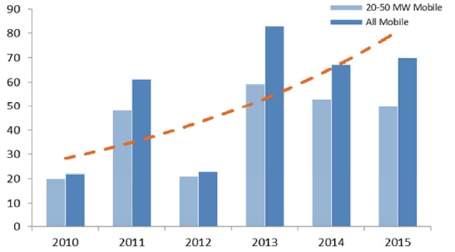

As significant is a trend emerging globally, which suggests a clear shift is occurring in the way power is being used. Between 2010 and 2015, the number of units sold into global traditional stationary gas turbine markets of between 20 MW to 50 MW fell 70%. “However, during the same period the number of units sold into mobile gas turbine applications increased by 150%,” Siemens said. Many of these were for projects that required urgent delivery and rapid installation—and the bulk were installed in the Middle East, North Africa, and Latin America (Figure 6).
- Mobile industrial gas turbine sales required on a fast-track or emergency basis. Courtesy: Siemens
The mobile gas turbine market was worth $15 billion in 2016. “This market requirement has been slowly growing over the past 15 years with a CAGR rising from 6% in the early 2000’s to 13% in 2010 to over 20% in recent years,” it said.
