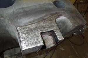

Due to the welding and machining operations performed on the outer shell to repair the damage to the axial fit face surfaces, this slightly changed the axial position of the sealing face and reduced the overall width of the tongue for the tongue and groove fit in the outer shell. In order to restore the correct axial position of both the HP and IP inner shells within the outer shell, and to ensure the tongue and groove fits had the correct designed clearances, the entire 360° seal faces and clearance faces of the HP and IP inner shell fits were weld restored and machined.
HP Inner Shell – Typical Localized Welding of HJ & Axial Fit
Weld repairs and a full stress relief re-rounding operation of the HP and IP inner shells was performed by MD&A’s experts in St. Louis Turbine-Generator Repair shop. The HP and IP inner shells were re-rounded to within 0.036” of original design diameters after the stress relief re-rounding operation was completed.

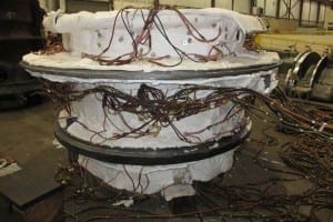

Also, due to the amount of as-found horizontal joint gaps and diameter out of roundness with all studs tensioned, it was decided to perform horizontal joint welding and heat treatment of both the HP and IP inner shells. The repair process involved weld preparation, NDE, preheating, welding, heat treatment, final machining, and checks.
IP Inner Shell – Insulated & Preheated for Welding
