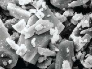

Trona is a naturally occurring mineral that is produced in Green River, Wyoming (Figure 1). Interestingly, milling of trona is not necessary, as it is already produced as a fine powder. Although milling trona can increase its SO3 removal efficiency, the cost to do so must be balanced against the added cost of equipment and maintenance.
1.    Raw trona. A microscopic view of raw trona. Courtesy: Solvay Chemicals Inc.
