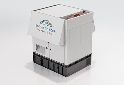

Enchanted Rock’s new ERT500 natural gas generator delivers up to 500 kW of dispatchable onsite power in a compact footprint. Courtesy: Enchanted Rock
The ERT500 natural gas generator is the next evolution of Enchanted Rock’s proven platform, meeting or exceeding industry standards on key attributes such as power density, start time, transient management, and emissions. For example, it outperforms typical diesel generators by surpassing ISO 8528-5 G3 step-load requirements, delivering faster, more stable response to sudden load changes. With 500 kW ESP and 450 kW LTP/PRP in a compact 10′ x 8′ footprint, the ERT500 combines modular scalability and flexible operating modes with ultra-low emissions. Integrated GraniteEcosystem™ controls collect 10x more data than previous models, enabling predictive maintenance and enhancing long-term reliability.

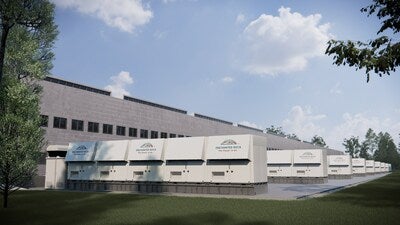

Enchanted Rock’s RockBlock modular onsite generation units deployed outside a data center campus, demonstrate scalable, utility-grade resiliency without the costs and constraints of diesel. Courtesy: Enchanted Rock
