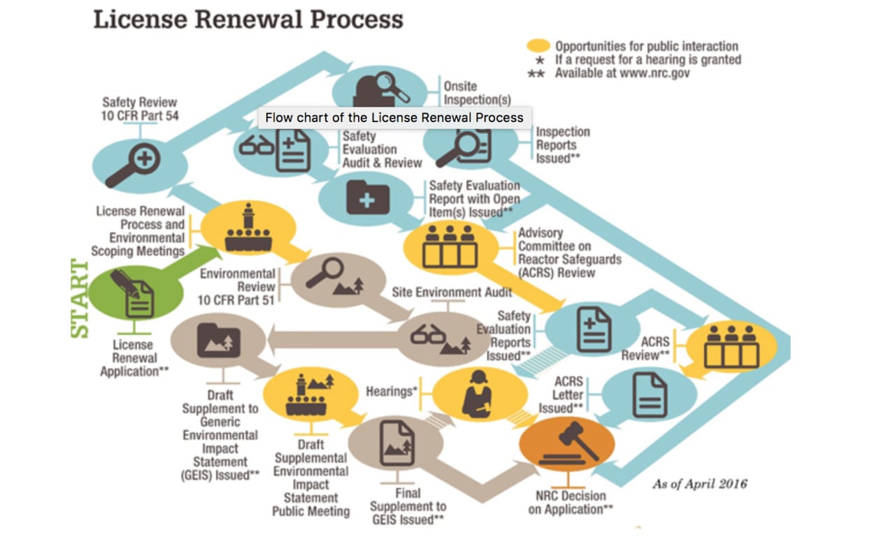

The NRC is authorized under the Atomic Energy Act to issue licenses for commercial power reactors to operate for up to 40 years—a period known as “extended operation.” According to the NRC, economic and antitrust considerations, not limitations of nuclear technology, determined the original 40-year term for reactor licenses. “However, because of this selected time period, some systems, structures, and components may have been engineered on the basis of an expected 40-year service life,” it noted.
License renewal is a process that essentially proceeds along two tracks and takes up to three years to complete.
1. The NRC’s license renewal process. Source: NRC

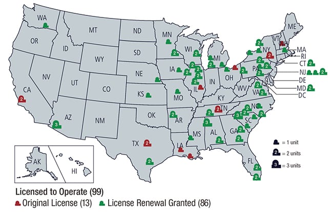

Of 99 nuclear reactors licensed to operate in the U.S., 86 have been granted an initial 20-year license renewal.
2. License renewals granted for operating nuclear power reactors. Source: NRC
