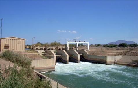

Another fallacy in the DOE plan is that it ignores important generating technologies that are at least as resilient as nukes and coal, arguably more so. The nation’s most important renewable energy resource is hydro. Hydro plants, conventional and pumped storage, have far more fuel – water – on site than coal plants and even nuclear stations. The DOE proposal appears to have blanked on this reality.
Is this a resilient generating resource?
In its comments on the proposed rulemaking, the National Hydropower Association said, FERC “should not be focused on specific generating resources, but on the desired regional reliability and resilience services sought. As such, importing requirements specific to one industry may impede the effectiveness of the proposal for which other industries will be eligible.” The NHA comments added, “Hydropower is generally a seasonal resource, with minimal water supply availability known for months, so it is able to meet nearly any duration threshold – with clean, emission free energy.”
