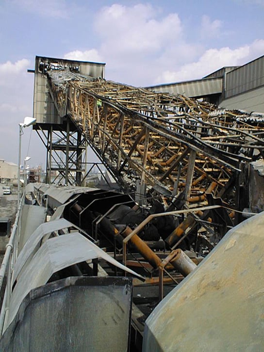

If a conveyor belt does not perform according to the manufacturer’s claims—by wearing prematurely, ripping too easily, or disintegrating due to excessive heat or because of oil penetration—the risk to life and limb is relatively small. Yes, it can be very expensive, but it is generally not life-threatening. But if a fire retardant conveyor belt does not resist fire the way that it should, then it can literally “convey” a fire throughout the site, resulting in catastrophic consequences (Figure 1).
1. A coal conveyor fire can be disastrous. Courtesy: Dunlop
The discovery that a belt is not sufficiently fire retardant is only likely to be made after it is too late. Anecdotal, as well as factual, evidence gained from laboratory testing indicates that many users of conveyor belts, including power stations, may be using belts that are not as resistant to fire as they are supposed to be. In a growing number of instances, many sites that should be using fire resistant belting are operating with non-fire-resistant belts simply in the pursuit of cost savings.

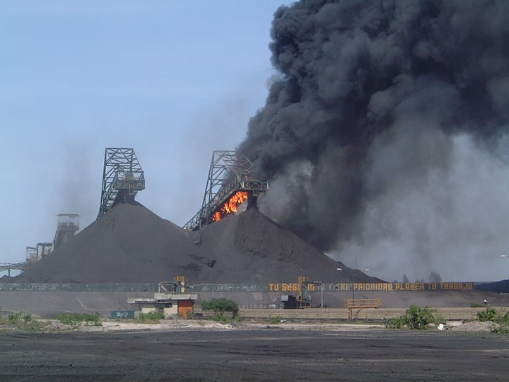

At the same time, insurance companies are becoming increasingly concerned. According to at least one major insurer, claims for fires directly involving conveyor belts are costing an average of nearly $8 million per claim (Figure 2).
2. Pay me now or pay me later. Courtesy: Dunlop

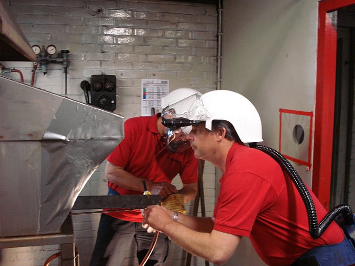

One of the most problematic aspects of fire testing rubber conveyor belts for industrial use above ground is that most of the test methods were established many years ago specifically for underground mining belts. Independent testing institutions must compete the complex and costly testing (Figure 3). Because of environmental regulations, large-scale gallery fire tests now involve using a 12-meter-long container filled with carbon to filter the smoke emissions before they are released into the atmosphere. In order to be awarded a safety standard certificate, every belt type has to be independently tested. For some tests a minimum of 20 meters of belt is needed.
3. Conveyor belt fire resistance testing is very involved. Courtesy: Dunlop
Such tests can easily cost up to €20,000 ($27,500). For the manufacturers of solid woven underground mining belts and steel cord belting, this is not a particularly big problem because there are a relatively small number of different belt types that have to be supplied for testing in large quantities. Although the test certificates are valid for several years, these large-scale tests present a huge and costly problem to manufacturers of rubber belting for above ground use, because there is a much wider range of belt types. Such complex test methods have made it extremely difficult to develop improved levels of fire safety, because if a belt sample fails the tests, then the technicians have to go back to the drawing board to make further changes to the rubber compound and then embark on another round of expensive tests.
