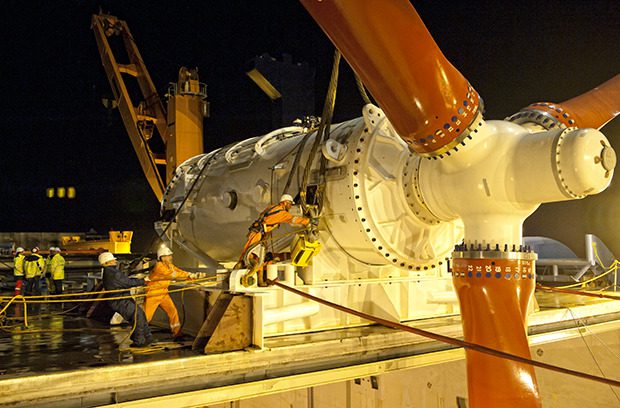

This image shows the AR-1000 tidal turbine being deployed at the EMEC test site. Courtesy: Atlantis Resources Corp.

Scottish developer Atlantis Resources Corp. has been busy developing and deploying tidal energy units in the MeyGen cluster in the Pentland Firth. Phase 1A is scheduled to be operating autonomously at full 6-MW capacity by the end of September. From there, developers hope to scale up to over 100 MW and beyond in coming years.
“The deployment at MeyGen—since the technologies were initially tested at EMEC—is a bit like graduating, and going off and getting your first job,” said a proud Kermode. “We have proved out the alchemy that you can convert seawater into electricity. These tidal machines have started to harvest the inherent energy at a commercial scale,” he continued.
