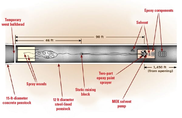

A hydroelectric power plant in the West, owned by a large multi-region utility, experienced a flash fire that killed five and injured three construction workers in October 2007. Painting contractors had begun epoxy recoating of the 1,530-foot interior steel wall portion of the penstock, which is a total of 4,300 feet long. The penstock is the conduit or tunnel that delivers the water from the reservoir to the hydroelectric turbine-generators. The tunnel interior diameter varies between 12 and 14 feet at this plant. Recoating of the walls is a common maintenance requirement to maintain structural integrity, maintain water tightness, and prevent corrosion of steel surfaces (Figure 1).
PWR_040114_Safety_Fig1
1. Penetrating the penstock. A 4-foot by 6-foot opening was cut into the penstock for contract worker access. Two wooden bulkheads were constructed to contain and remove sandblasting and grinding debris and to provide work area ventilation via flexible ducts. The result was a confined space with only a single means of egress. Source: U.S. Chemical Safety Board
Workers experienced problems with their paint spray equipment shortly after beginning the epoxy application. The spraying was stopped and the sprayer system was cleaned using the industrial flammable solvent methyl ethyl ketone (MEK). The cleaning work was done at the work location within the penstock. The National Institute for Occupational Safety and Health (NIOSH) lists MEK as a “highly flammable” solvent, with a flash point below 73F.
A flash fire occurred when a static spark ignited the solvent inside one of the two epoxy feed hoppers. The fire spread quickly when other plastic containers of the solvent (later determined to be approximately 16 gallons) and epoxy erupted. Four workers near the exit were able to quickly exit the penstock with minor injuries. Emergency response teams were unable to reach the five workers trapped behind the fire in the penstock before they succumbed to smoke inhalation. The fire occurred when the safety inspector and general foreman were away from the worksite having lunch.
The subsequent investigation conducted by the U.S. Chemical Safety Board (CSB) focused on “the technical and organizational causes of the fire.” The CSB investigated the incident to determine the root and contributing causes to help other plant owners prevent similar tragedies from occurring.
The investigation determined the technical cause of the incident was the ignition of the MEK that was circulated through the sprayers for purposes of cleaning. The work occurred in an open area within the penstock, although “a number of ignition sources present or created by the work activity were not eliminated or controlled.” Specifically, the MEK circulating through nonconductive hose was a likely source of a static spark that ignited the MEK. The other possible ignition source was halogen lamps used to illuminate the penstock, none of which were of explosion-proof construction (Figure 2).

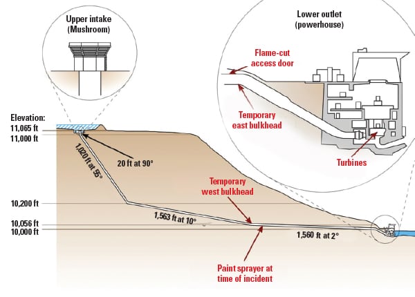

PWR_040114_Safety_Fig2
2. Inside the penstock. Five workers were trapped between the west bulkhead and fire that began with the solvents and epoxy compounds. Properly equipped and trained rescue workers were about 75 minutes away. Source: U.S. Chemical Safety Board

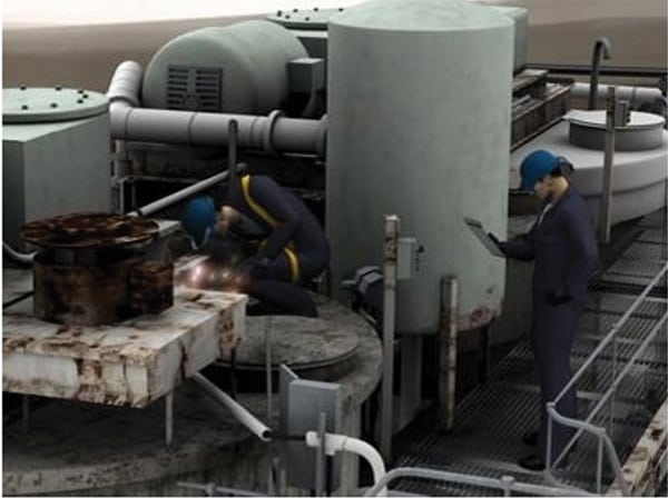

PWR_040114_Safety_Fig3
3. Dangerous work environment. A still shot taken from a CSB animation shows the location of the workers at the time the fumes in the tank were ignited by the welding. Source: U.S. Chemical Safety Board
In this particular incident, the tank contained flammable vinyl fluoride (VF) gases produced from the liquid VF used in the manufacture of photovoltaic panel films and other consumer goods. VF is a colorless, heavier-than-air, highly flammable gas at ambient conditions. The tank containing the VF vapor was 11 feet in diameter and 19 feet tall, with a volume of 10,800 gallons.

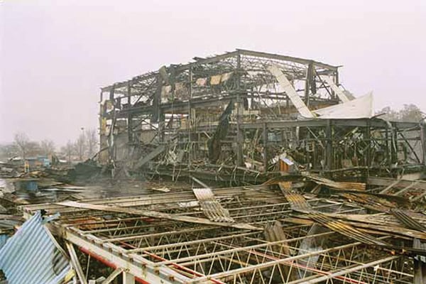

PWR_040114_Safety_Fig5
5. Explosive mixture. A pharmaceutical manufacturing plant allowed polyethylene dust to collect above a suspended ceiling that eventually led to an explosion, destroying the plant. Workers were not informed that the dust residue was a safety concern. Source: U.S. Chemical Safety Board
