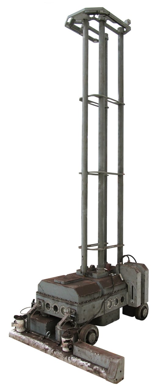

1. The “Inspector.” This underwater robot can be used to examine water storage tanks as an alternative to draining the tank or using divers. Courtesy: Newton Labs
The Inspector is a semi-autonomous underwater robotic delivery platform designed to precisely position a variety of sensors, measuring instruments, or repair tools that are used in the evaluation and maintenance of water storage tanks at nuclear power generating stations. There are four major elements to the Inspector system: the robot, the global observation device, the navigation and operation software, and the NDE systems.

As a delivery platform, the Inspector is exceptionally maneuverable thanks to an independent, steerable drive wheel system and a split, pivoting chassis design. Wheel pods can rotate 193 degrees, and each wheel drive motor is independently variable. Steering and drive motors are software coordinated, thus giving the Inspector a full range of motion: forward and backward, side-to-side, spin on central axis, diagonal “crabbing,” and radius turns.
Inspector robots are designed to fit through narrow tank entrances or manways (minimum diameter of 19 inches). Lower tank manway entry can also be used if the site can drain the tank just below the bottom entry. The top speed of the Inspector is in excess of six inches per second. The split chassis design allows the Inspector to maintain four-wheel ground contact while moving across surfaces of different elevations.
During deployment, a 72-in-tall mast is attached to the top of the robot. At the peak of the mast are five light-emitting diode (LED) lights, which allow the robot to be tracked by the navigation software. The mast keeps the lights above any sediment or turbidity that may be present in the bottom of a tank.
The robot chassis contains five on-board video cameras, which provide 360-degree, plus down-looking, live video. Additionally, there are laser range finders on all four sides to aid in positioning the unit near the wall of a tank. A built-in down-pointed laser scanner with 0.01-in resolution can measure welds on the floor plates, as well as areas of corrosion. The scanner produces a detailed point cloud output that can be used by a 3-D software program to generate a measurable computer-aided design (CAD) model.
Inspector robots are designed to accommodate several mounting options for NDE equipment, enabling them to map and inspect in very close proximity to the tank wall or internal structures. The sensor mounting options include two indexed arms, mounted to the side of the robot, to which a variety of sensor probes may be attached; an optional, low-slung, arm-mounted equipment plate that may be attached onto the starboard side; and the top deck, which can accommodate additional sensor mounting.

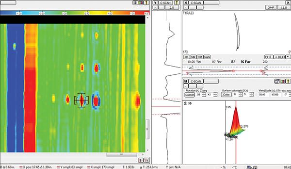

The Inspector’s robotic arms and probe holders deliver IHI’s qualified probes at a specified position for acquisition and analysis using state-of-the-art technology and software. The Inspector is equipped to deploy a phased-array ultrasonic transducer (PAUT) and an eddy-current array probe. The approach used for the tank inspections minimizes the time required for data collection and analysis and maximizes the quality of acquisition.
As part of the data analysis process, 3-D models of system components can be integrated into the system to aid with data analysis interpretation and with indication and corrosion evaluations. Well-qualified and experienced data analysts evaluate the correlation of the indication or corrosion with respect to the inside or outside examination surface proximity. Feedback is provided to the customer in a detailed report with flaw images, dimensions, and locations. The use of 3-D visualization during data analysis provides efficient and auditable data analysis protocols of complex components.
Any potential flaws that may be open to the surface, or opposite surface flaws that are approximately 50% through, can all be verified using eddy-current testing (ECT). An ECT array sensor located adjacent to the PAUT probe complements the PAUT data by providing additional information regarding any surface, and some opposite surface, indications. IHI uses a semi-flexible, multi-coil, driver pick-up mode ECT probe.
Using the latest technology, IHI is able to perform real-time processing, greatly increasing the quality of inspections (Figure 3). Analysts can review the data as it is being obtained, streamlining the process and significantly increasing productivity.
PWR_020115_FOM_Fig3
3. Painting the picture. Strip charts, 2-D, and 3-D graphics allow experienced analysts to easily identify flaws. Courtesy: IHI Southwest Technologies Inc.
