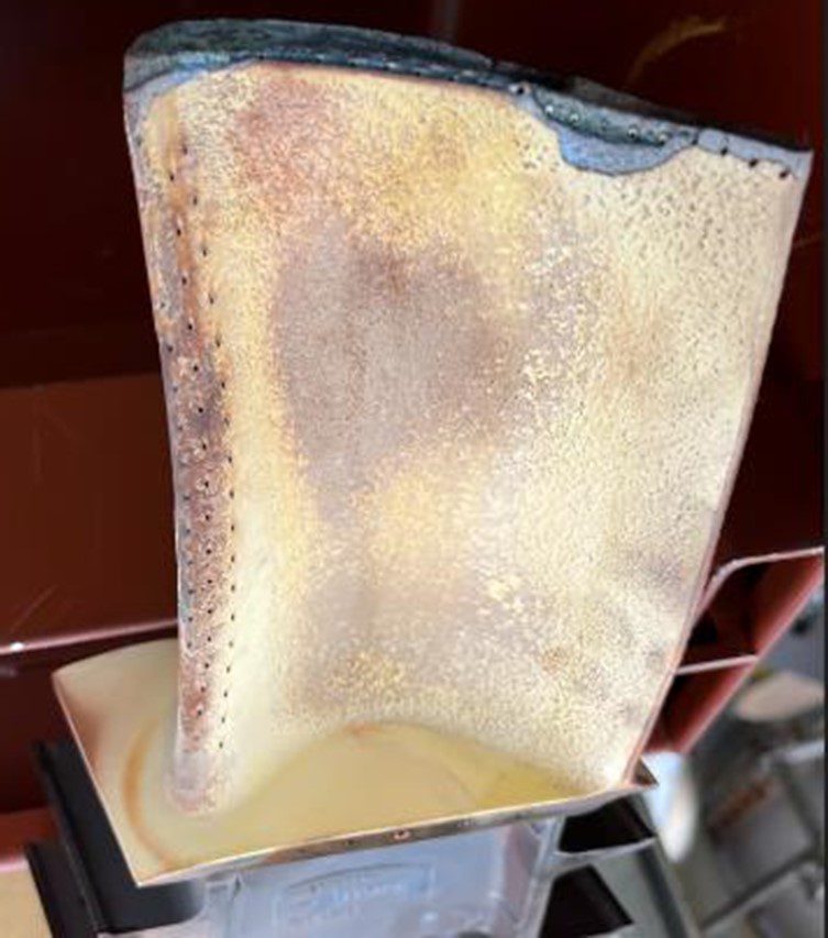

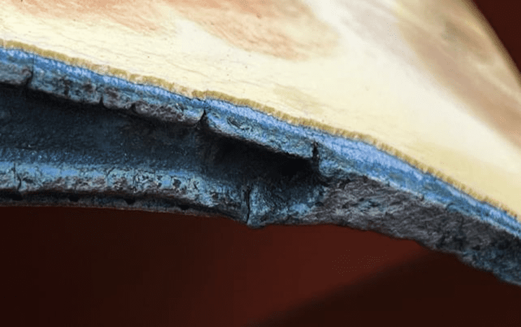

MD&A has also developed a comprehensive repair process for 7FA.04 1st stage buckets, addressing various issues commonly observed in the incoming condition. Problems such as tip cracks, tip cap oxidation, and wall thinning, as well as airfoil TBC coating missing with oxidation through the bond coat and into the parent material.The 7FA.04 1st stage bucket tip restoration process includes the removal of all cracks and airfoil damage, single crystal proprietary weld processes using high-quality materials, and the installation of a new tip cap.
MD&A implemented CT Scanning (3D X-ray) and white light scanning to develop the optimal welding techniques to ensure a top-quality tip welding restoration structure.  Metallurgical testing was performed to ensure that the process produced buckets free of cracks and re-crystallization at the airfoil tip cap.  The weld material above the tip cap is a high oxidation and erosion resistant structure that is proven to perform well in single crystal blades at high firing temperatures experienced in AGP applications.
The final configuration of the blade tip is accomplished by using a multi-electrode configuration tool during the electrical discharge machine process (EDM).  After re-establishing the tip geometry, all new cooling holes are established to ensure proper tip cooling.  The tip restoration technique ensures no double or triple drilling cooling holes.  This provides the best airfoil tip cap integrity.  All components are then x-ray inspected and airflow tested.
Once the repairs and pre-coat inspections are complete, MD&A experts apply a NiCoCrAlY HVOF bond coat.  This coating is derived from military gas turbine technology and contains additional elements such as Hafnium and yttrium that provides for a superior oxidation resistant bond coat.  MD&A offers a low conductivity (Low-K) Thermal Barrier Coating that helps reduce the bulk operating temperature of the 7FA.04 1st Stage bucket.  Lowering the operating temperature provides for the long-term preservation during the operational lifespan of the component.

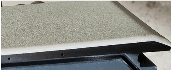

MD&A experts have also repaired 7FA.04 1st shroud tiles. This repair involves implementing true abradable coatings in new and repaired tiles to minimize stress on the blade tip during rubbing incidents.
