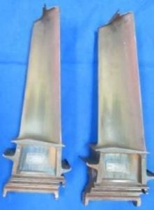

7FA 2nd Stage Blade Case Study
Our San Antonio facility evaluated two sets of 7FA 2nd Stage Blades to determine if they were capable to operate for a third service interval. The blades had operated through two service intervals and underwent one repair.
An x-ray inspection was performed on the components in their as-received condition. No areas of concern were detected, and no clogging was observed on the cooling holes.

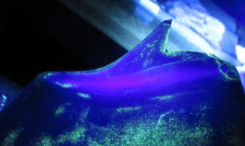

An FPI inspection was performed to look for the presence of cracks. The area around the shroud radius was also evaluated for cracks. No major areas of concern were found during the preliminary FPI inspection.
The condition of the internal coating was deemed acceptable and in good condition to operate for one more service interval. The external coating protected the external surfaces and was recommended for removal to allow a good FPI inspection of the hot gaspath surfaces.

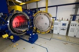

For heat treatment, our experts utilize a vacuum heat treat furnace, where we control the heating and cooling of metals to alter their physical and mechanical properties. There is a pre-weld heat treatment, post-weld heat treatment, and a diffusion or aging heat treatment.

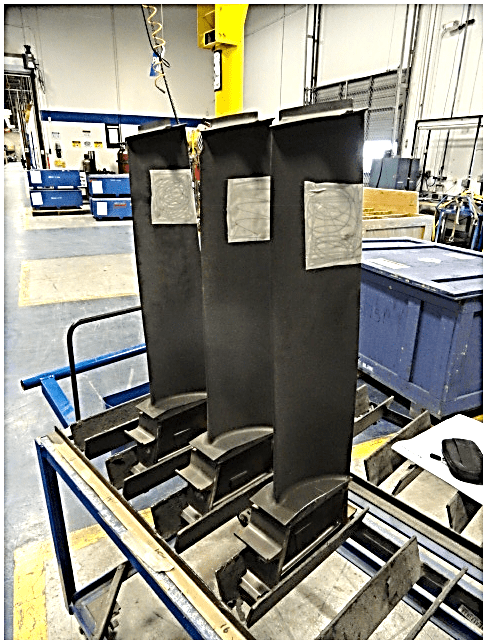

9FA 3rd Stage Blade Extended to 120,000 FFH
Our San Antonio facility received three 9FA 3rd stage blades where they underwent detailed inspections, including microstructural assessment and high-temperature testing.
Observations indicated galling in root serrations and seal pin surfaces, as well as the presence of two distinct casting houses to produce the row of buckets.
The scope of work included a visual inspection, dimensional measurements, and an x-ray inspection. Also included were a microstructural assessment, high-temperature mechanical properties testing, assessment of material condition at multiple locations, heat treatment of specimens to demonstrate the effects of repairs, and high-temperature mechanical property testing performed a post-heat treatment.

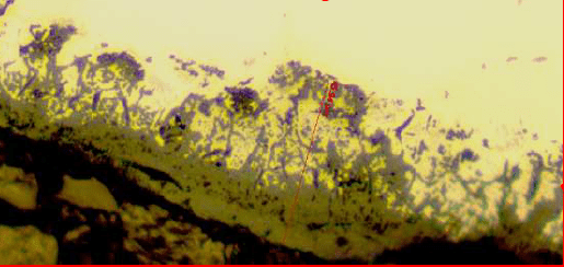

Inspections showed that the manufacturer’s heat treatment did not achieve full solutioning. All blades also displayed a two-phase gamma prime structure within each grain, indicating that the previous repair heat treatments were not optimized to achieve a good structure. In addition, all three blades had surface oxidation and depletion. Even so, all of the components were deemed repairable.
Surface Oxidation on Lead Edge
Additional repair work included grit blasting and polishing the gaspath surfaces to remove an oxide layer, a complete X-ray inspection, and HVOF coating and diffusion to reduce surface degradation.

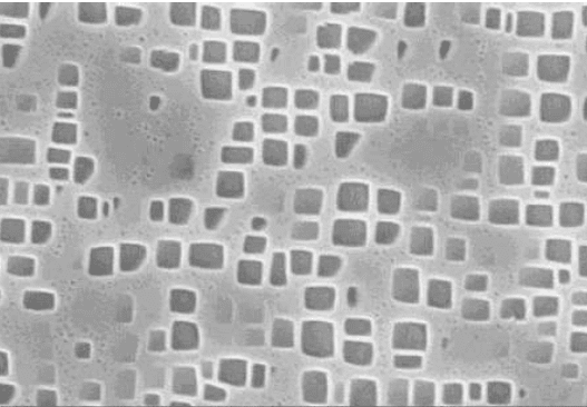

Repair heat treatment was applied to several samples from the test blades, then evaluated to determine the material’s response to the heat treatment. The material responded well to the heat treatment on all three blades. The primary gamma transformed to a more cuboidal morphology, which provides for improved component creep life.
Microstructure
These third stage blades were evaluated and subsequently determined to be candidates for a Lifetime Extension (LTE) repair. The 9FA 3rd stage blades’ lives were extended to 120,000 FFH.

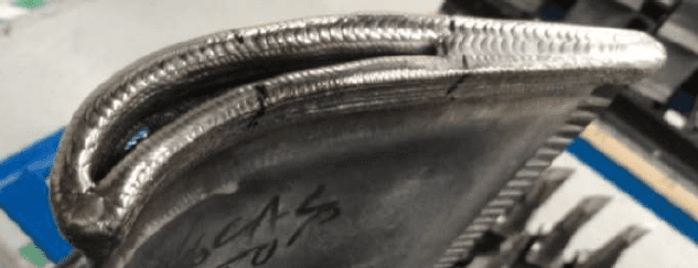

The external TBC appeared in good condition. However, the blade tip has significant oxidation. This is most likely due to the weld wire selected during the previous repair. All other inspections were normal.
One heat-treated blade’s metallurgical properties were then evaluated and compared to the other vane in the as-received condition. The evaluation confirmed that the heat treatment process would heal and improve the gamma prime structure.
Based on all the evaluation performed on the two 2nd Stage turbine blades, our experts determined that the full set was a viable candidate for life extension to 75,000 EOH.
The measurements of the blade tip cap indicated that there was sufficient material to perform a successful weld build up repair, so they removed most of the previous weld repair. Because of heavy oxidation on the blade tip, an oxidation-resistant alloy was used. Our weld repair procedure has demonstrated to provide excellent oxidation resistance during operation.
