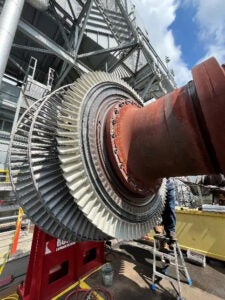

During disassembly of the first unit, MD&A Gas Turbine Services personnel first removed roof sections, recorded thrust and lift checks, removed all relevant casings, and labeled/removed relevant piping/hoses. Half shell readings were taken on the turbine and compressor by recording all rotor and stator tip clearances.
The service run 7FA.04 hot gas path components were inspected and analyzed onsite by specialists from MD&A’s San Antonio Service Center to determine the potential for future component repairs. Our team has extensive knowledge on a range of gas turbine component repairs, including weld repair, blending, dimensional restoration, and machining. They can extend the service life of gas turbine components whose OEM service limit has passed or whose configuration is no longer suitable to operate. These experts provided feedback on the component repairability.
For these outages, the turbines’ first, second, and third stage buckets were removed and replaced with Customer provided components.
MD&A New turbine blades on 7FA.04 rotor

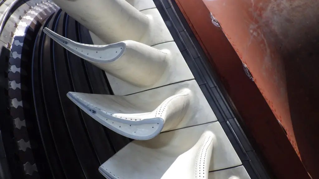

For this unit, turbine first, second, and third stage buckets were replaced as were nozzles and shrouds.
MD&A New S1-S3 buckets were installed
