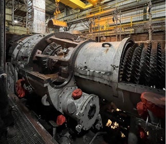

Mechanical Dynamics & Analysis (MD&A) performed a GE® Frame 7EA Gas Turbine Major inspection and a 7A6 air cooled Generator Minor inspection including planned maintenance for a peaking unit in the Midwest.
The planned scope of work included replacement of combustion and hot gas path (HGP) hardware and components, IGV gears, ring gear, and bushings. Additional replacements included the torque converter, flow divider, and liquid fuel stop valve. The fuel gas stop valve was also to be removed and replaced. Once completed, the team conducted generator testing. Recommendations for future repairs and considerations were provided as part of the inspections.

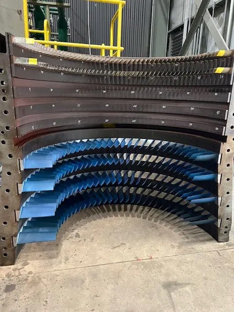

MD&A’s experts inspected several compressor components. These include the bellmouth casing and inlet guide vanes which were cleaned, inspected and returned to service. The IGV inner and outer bushings as well as the spring/thrust washers were found to have light wear and replaced with new parts. The team mapped and buffed the compressor casing. They also mapped and blended the compressor’s rotor blades. The stator vanes were also removed, cleaned and inspected, demonstrating heavy rubbing with rolled material on the tips. MD&A’s experts blended, performed NDE and reinstalled the vanes.
New Stator Vane Segments Installed

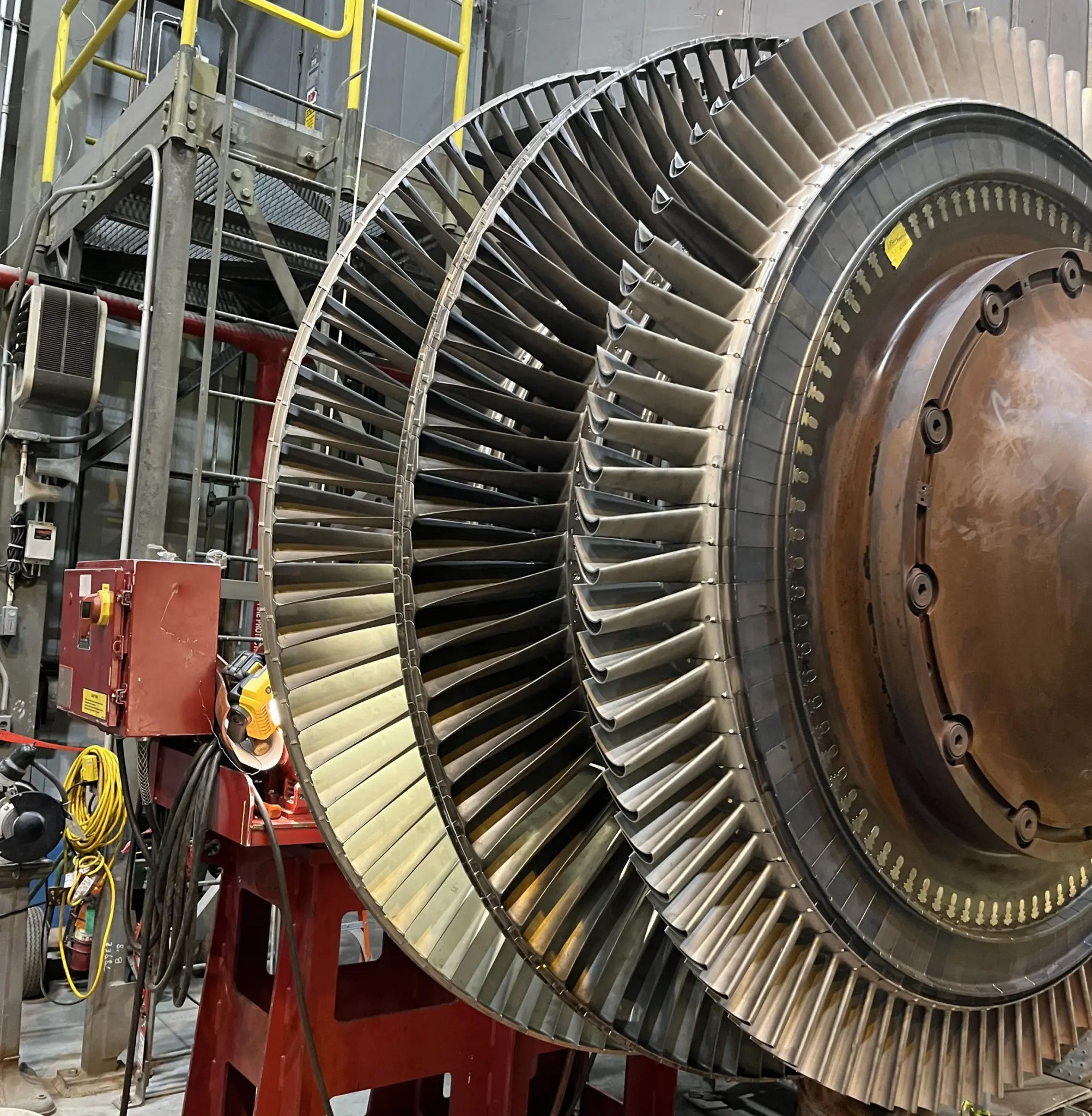

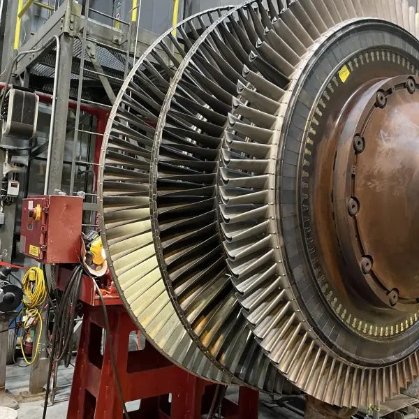

MD&A’s team performed major repairs and replacement within the turbine’s hot gas path. Buckets for the 1st, 2nd and 3rd stage were all removed and inspected. The 1st stage buckets showed discoloration and TBC loss. MD&A replaced the buckets, pins, and D-keys. The 2nd stage buckets also some discoloration and normal wear. The 2nd stage buckets and pins were replaced. The 3rd stage buckets showed normal wear and missing material. They were replaced along with the pins.

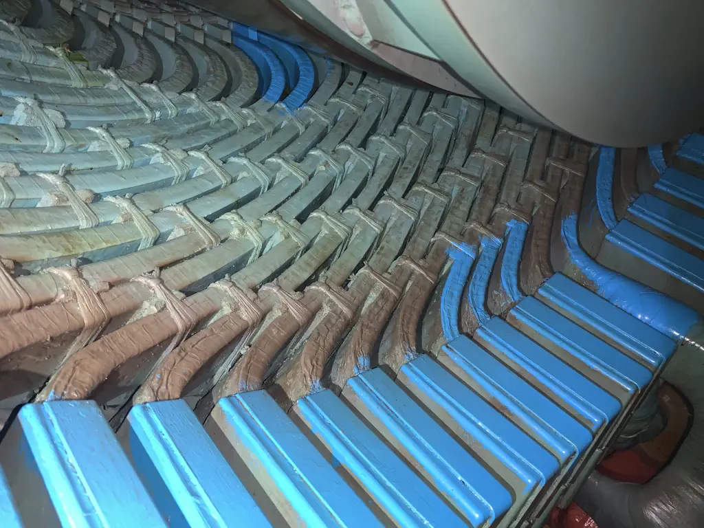

MD&A’s experts also conducted a minor inspection of the generator field and stator. The scope of the inspection included visual inspection, borescope inspection and electrical testing. The field was found to be in good condition overall, except for some minor contamination which was removed. Other observations were noted, such as additional contamination and insulation migration, but not actionable at the time of inspection.
Electrical testing was conducted on the generator field including 500VDC IR with PI, DLRO and AC impedance testing. All results were satisfactory.
MD&A’s experts also performed a visual and mechanical inspection of the TG1 stator. The axial support hardware was found to be loose and was tightened and secured with epoxy. Other observations were made including oil contamination throughout the machine, minor greasing in end winding areas and partial discharge at phase breaks on the stator end arms. The team also completed visual inspection of the neutral enclosure, which revealed typical oil and dust contamination.
Stator electrical testing was performed as well. This included RTD element resistance and 500VDC IR test, DLRO, 5kVDC IR with PI and CD leakage testing. All results were satisfactory.

U/H CDC Installed
