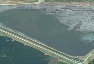

The traditional approach to operating ash ponds has been to create a large settling basin where the ash drops out of the stream and water is decanted and returned to the power house area for additional sluicing, with the goal being inexpensive removal of waste from the boiler operation. The mixture is transported to the settling point or pond inlet by pumping it through a pipeline, a method that is usually much less expensive than trucking or dry conveying. Some plants may manage both fly ash and bottom ash with this method, whereas others may manage only the heavier bottom ash in this manner. Once the ash and water mixture reaches the pond, it may be manually distributed by moving the discharge end of the pipe to enhance settling, or the pipe may be stationary and the mixture will seek its own path (Figure 1).
1. This large settling pond has no control of flow. Note the large delta of ash near the inlet. Courtesy: Skelly and Loy
As a rule of thumb, settling ponds should be designed such that the length is approximately twice the width. This configuration enhances settling. However, many of these ponds are constructed with an elevated dike, and they are allowed to fill and consolidate over time. As the impoundment fills, another dike is constructed above the first, creating additional storage volume. The new dike would likely be set back from the original for stability considerations. In this manner, a plant can continue to place ash within the original footprint allocated for waste management, which minimizes operating costs.

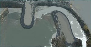

Removal of settled ash material from a pond is accomplished by dredging, either with a wet dredge or through excavation by more conventional equipment. A wet dredge is a barge-mounted cutter head with a pump that drags flexible pipe as it cuts and sluices the removed material to another area for settling, much like the primary pond. The recovery method described is popular because it uses conventional equipment owned by a typical contractor or managed by plant employees. A word of caution: Study the specific needs of your facility, the available markets and disposal requirements that apply, and the available pond area to formulate your specific recovery plan (Figure 2).
2. This settling pond has dikes to control flow and allow for ease of cleaning. Courtesy: Skelly and Loy
When laying out a settling pond for recovery of solids, accessibility of the settled solids is an obvious consideration. If a long-reach track hoe or similar equipment is to be used, then the access requirements and the dike design will be different than those required by a dredge. The dikes perform several functions, such as directing the flow of water and ash through a much longer path from inlet to discharge points, thus greatly enhancing retention time and settling of solids. Dikes also offer an opportunity for equipment to access channels established between the dikes so that these channels can be regularly cleaned even while the pond is in operation.
The width and stability of dikes are very important for safety when operating excavating and hauling machinery. The owner must create a safe environment for the dredging operation and avoid undermining the structural integrity of the dikes. There are options such as sheet piling that can be used to protect certain areas that may be susceptible to stability problems. Regardless, a good safety training program for operators of heavy equipment is critical.
Not surprisingly, the heavier, larger ash particles drop out of the stream earlier, and recovery operations should be planned accordingly. In other words, cleaning the channel end closest to the pond inlet often yields larger material.

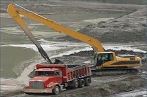

If material is to be dredged and hauled to the owner’s solid waste landfill, the ash will likely have to be dried before hauling, so an ample lay-down area will be required for air drying. The amount of material that is disposed in a landfill can be reduced by opportune use of the waste as drainage media, low-permeability top dressing, or other means to offset the need for purchased materials. This approach will not only reduce overall operating costs for the facility but also will lengthen the life of the owner’s landfill or pond areas. Some processing may be required to utilize these materials in a beneficial way, but it is usually well worth the additional cost (Figure 3).
