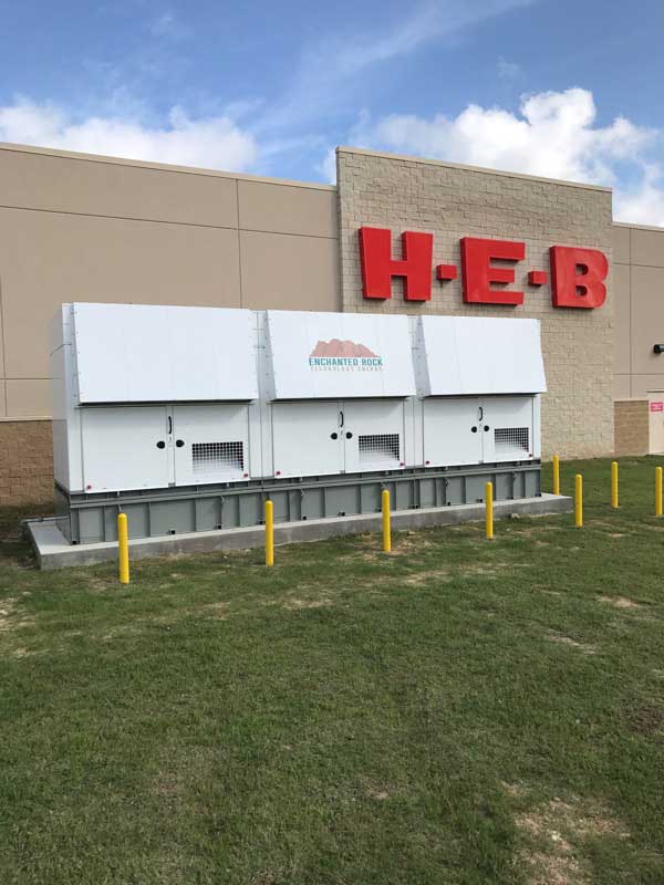

Enchanted Rock, which designs backup power systems for businesses, installed its microgrids at H-E-B supermarkets around Houston over the past year after signing a deal with the grocery chain in 2016. The systems receive natural gas from underground pipelines that are not affected by flooding or high winds.
An Enchanted Rock microgrid system is shown outside an H-E-B grocery store in Houston, Texas. Enchanted Rock has installed the natural gas-powered generation system at H-E-B stores and other businesses in Texas. Courtesy: Enchanted Rock
