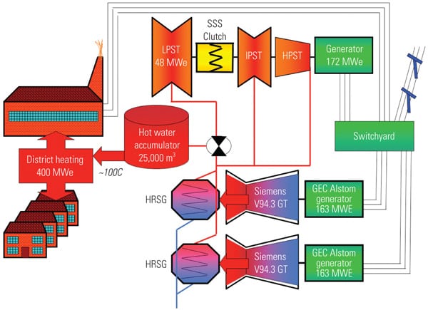

The second unit—Vuosaari B—went online in 1997, using the newer and much larger Siemens V94.3 gas turbines (now called SGT5-4000F), which are rated at 163 MW at an ambient temperature of 0C, and higher during winter. The exhaust goes to a Foster Wheeler Energia Oy boiler, which drives an ABB Stal steam turbine (145 MW backpressure steam turbine only, 172 MW backpressure and condensing turbines both operating) connected to a 200-MVA GEC Alstom generator.
In winter, the plant can operate at up to 92% efficiency when generating 470 MW and 400 MW(thermal) of district heat.
Simple Energy Storage
As part of its efficiency plan, the Vuosaari plant creates hot water overnight and stores it in a 25,000–cubic meter storage tank at close to 100C. Lampinen compares it to the way that natural gas pipeline operators pressurize a pipeline as a means of storing energy in pipes (Figure 6).
6. Efficient thermal storage. Thermal energy produced by the plant during the night can be stored as 100C hot water that’s ready for use in the morning. The overall energy usage at Vuosaari Power Plant is often above 90%. Source: SSS Clutch Company Inc.
“If you have already pumped the gas into the pipeline from Russia to Helsinki, if there is a breakdown in the pumping equipment, you have several hours to repair it,” he says. “We have the same situation, where we have the heat already stored. It is like a battery: We can charge the district heat network at nighttime, so in the early morning hours it is available.”

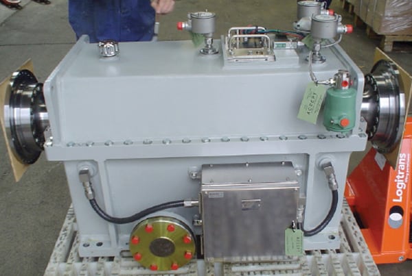

To give plant operators the operating flexibility required, ABB-Stal Utility Division used a clutch from SSS Gears Ltd. for Vuosaari B. The SSS clutch is a freewheeling clutch. When the device connected to the output shaft of the clutch is moving faster than the input side, the clutch disengages. When you apply power to the input side, however, and its speed matches or exceeds the speed of the output side, then the clutch engages (Figure 7).
7. Clutch operation. A clutch installed between the low- and intermediate-pressure turbines allows the plant to disconnect the low-pressure turbine and use that steam to produce thermal energy for district heating. When more electricity is required, the steam used for heating is redirected to the low-pressure turbine. When the low-pressure turbine reaches driveline speed, the clutch engages, adding its horsepower to the driveline to produce an additional 48 MW. Courtesy: SSS Clutch Company Inc.
The clutch was installed between the low- and intermediate-pressure turbines. When the demand for electricity is low at night, the steam can be redirected from the LP turbine and used to heat water, which is stored in a hot water accumulator for use when needed. As the steam is cut down, the clutch disengages the LP turbine from the HP/IP turbine. Then, when electricity demand rises, the steam is redirected to the LP turbine and the clutch reengages, bringing the 48-MW LP turbine back online. “The SSS clutch allows the turbine to operate as both a baseload and a peaking generator, while also providing district heating when needed,” says Lampinen.
