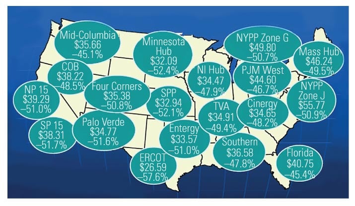

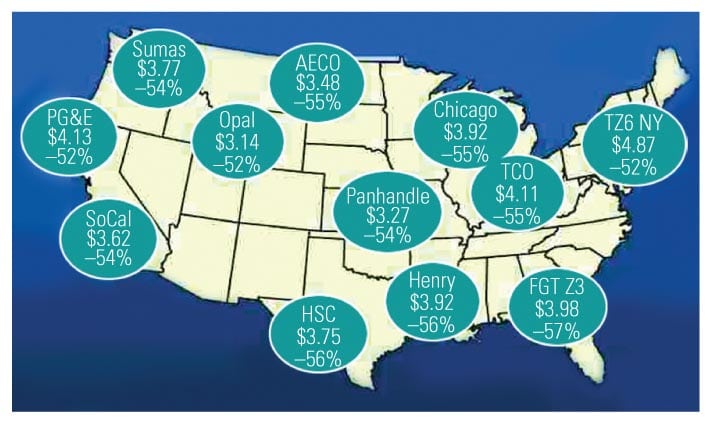

During 2009 overall consumption of electricity in the U.S. fell by 4.2%, the largest one-year drop in 60 years. Concurrently, the average prices of natural gas (Figure 3) and wholesale electricity (Figure 4) followed suit and fell more than 50%. Business and residential customers alike are looking for a better deal on their electricity purchases, further invigorating an already competitive buyer’s market. Although Texas is still the largest competitive market, 2009 brought some significant changes in other competitive power markets across the U.S.
3. Dipping gas prices. The average U.S. regional price of natural gas dropped from 2008 to 2009. Natural gas prices are shown in $/million Btu. Source: Derived from Intercontinental Exchange data
4. The electric slide. Wholesale electricity prices also declined over the past year. Data shown are 2009 wholesale prices compared to 2008 prices. The electricity price shown is in $/MWh. Source: Derived from Platts data
